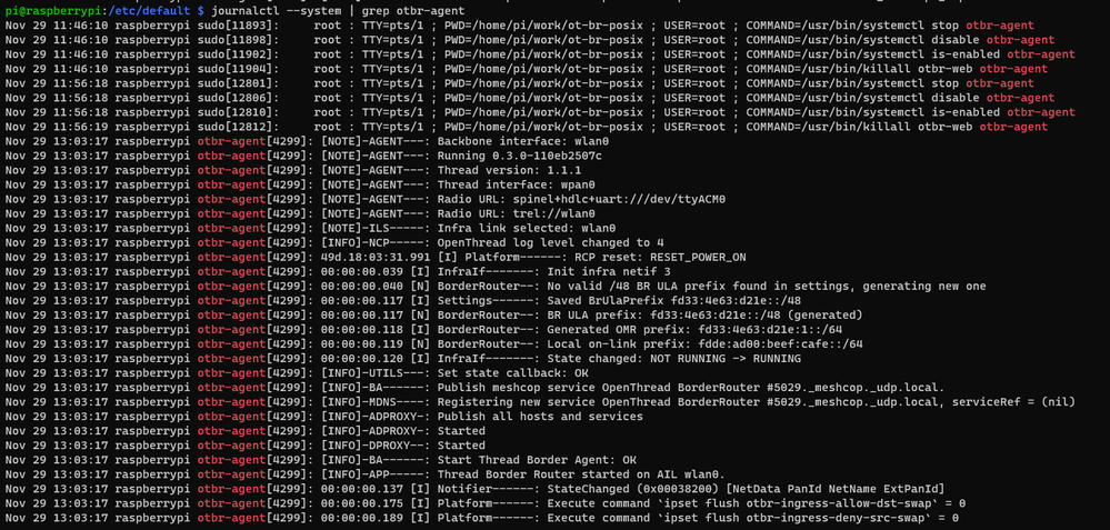

Hi JM,
On RPI3, I just did below:
$ git clone https://github.com/openthread/ot-br-posix
$ cd ot-br-posix
$ WEB_GUI=1 ./script/bootstrap

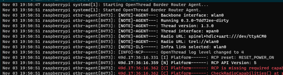

$ INFRA_IF_NAME=wlan0 WEB_GUI=1 BACKBONE_ROUTER=0 OTBR_OPTIONS="-DOT_THREAD_VERSION=1.1" ./script/setup
If without OTBR_OPTIONS="-DOT_THREAD_VERSION=1.1", the ot-br-posix uses thread version 1.3
Best Regards
Frank

‎2022-11-28 9:26 PM
Hi JM,
When building ot-br-posix on RPI3, the build process outputs
+ local builddir=/home/pi/work/ot-br-posix/build/otbr
+ mkdir -p /home/pi/work/ot-br-posix/build/otbr
+ cd /home/pi/work/ot-br-posix/build/otbr
+ cmake -GNinja /home/pi/work/ot-br-posix -DBUILD_TESTING=OFF -DCMAKE_INSTALL_PREFIX=/usr -DOTBR_DBUS=ON -DOTBR_FEATURE_FLAGS=ON -DOTBR_DNSSD_DISCOVERY_PROXY=ON -DOTBR_SRP_ADVERTISING_PROXY=ON -DOTBR_INFRA_IF_NAME=wlan0 -DOTBR_MDNS=mDNSResponder -DOTBR_VERSION= -DOT_PACKAGE_VERSION= -DOT_THREAD_VERSION=1.1 -DOTBR_WEB=ON -DOTBR_BORDER_ROUTING=ON -DOTBR_REST=ON
And the otbt-agent runs with Thread Version 1.1.1, it works with our STM32WB55 RCP
