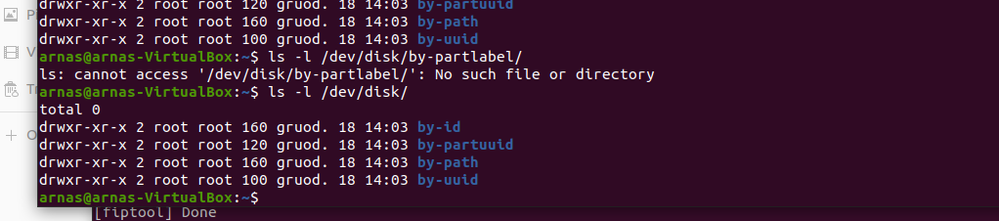

I also tried opening the SD card directlly on linux but the FIP storage does not appear:

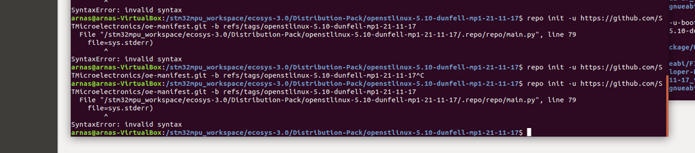

I have tried "How to populate the SD card with dd command" (url: https://wiki.st.com/stm32mpu/wiki/How_to_populate_the_SD_card_with_dd_command). But this requires the Distribution Package. Then I have followed the "https://wiki.st.com/stm32mpu/wiki/STM32MP1_Distribution_Package" to get the distribution package and got the following error to repo init ****. :
repo init -u https://github.com/STMicroelectronics/oe-manifest.git -b refs/tags/openstlinux-5.10-dunfell-mp1-21-11-17
 File "/stm32mpu_workspace/ecosys-3.0/Distribution-Pack/openstlinux-5.10-dunfell-mp1-21-11-17/.repo/repo/main.py", line 79
  file=sys.stderr)
SyntaxError: invalid syntax

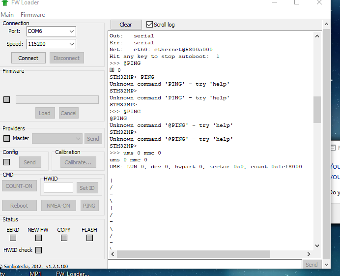

You have to stop u-boot during the boot by hitting a key, then you use the command:
ums 0 mmc 0

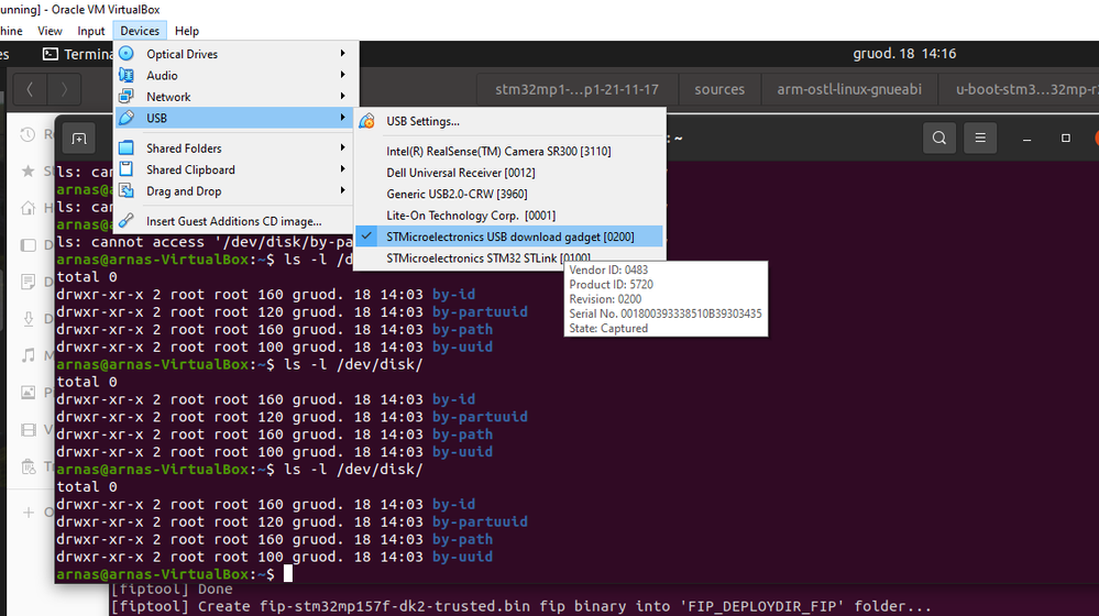

Well I had some issues when using VM - I am not able to access the SD card content via USB OTG. Windows do detect the SD card but i had issues accessing it (using oracle VM + ubuntu 18xx - also the issues I had previously also is related to too old ubuntu version, so I am updating it now and will see if it sortes it out). Thanks, Kevin, I will just update my ubuntu version and try again following your information - as always it's a great help for us all!, thanks !:D
Ok so perhaps you have an idea why my VM does not detect the USB OTG.
1.Reboot board and set the "ums 0 mmc 0" massstorage mode:

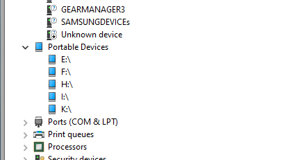

0693W00000Hp5ZuQAJ.png2.The masstorages (multiple) appear on windows.
0693W00000Hp5a9QAB.png3.Then I try to access the storage on my VM.
0693W00000Hp5aYQAR.png4.then i try to access it on the VM - but it does not detect the massstorage for some reason

I have tried following this to allow USB 3.0 devices input on VM:https://techsviewer.com/how-to-install-virtualbox-extension-pack-and-enable-usb-3-0/
But no luck, After selecting Devices->USB->STxxxx USB download gadget, the mass-storage device dissapears from windows but does not appear on oracle-VM. Also tested this with normal mass-storage device plugged to windows then selecting it via VM - works fine.

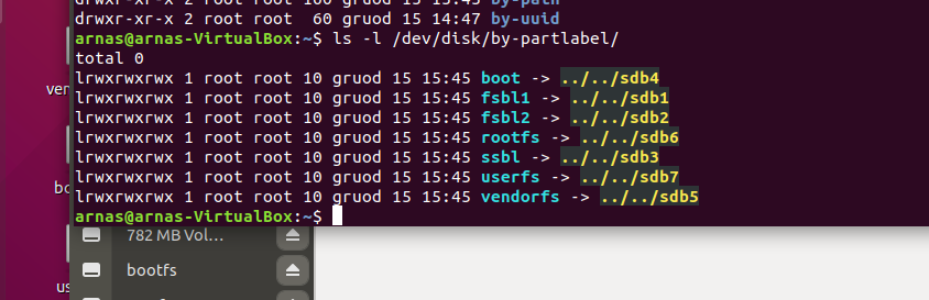

ok so so I switched from VM to dedicated PC and now I have no problems accessing the board as masstorage with "ums 0 mmc 0". I can fully access the device board now. And this is what i see:
ls -l /dev/disk/by-partlabel/
total 0
lrwxrwxrwx 1 root root 10 gruod. 22 12:48 boot -> ../../sdb4
lrwxrwxrwx 1 root root 10 gruod. 21 22:55 'EFI\x20System\x20Partition' -> ../../sda1
lrwxrwxrwx 1 root root 10 gruod. 22 12:48 fsbl1 -> ../../sdb1
lrwxrwxrwx 1 root root 10 gruod. 22 12:48 fsbl2 -> ../../sdb2
lrwxrwxrwx 1 root root 10 gruod. 22 12:48 rootfs -> ../../sdb6
lrwxrwxrwx 1 root root 10 gruod. 22 12:48 ssbl -> ../../sdb3
lrwxrwxrwx 1 root root 10 gruod. 22 12:48 userfs -> ../../sdb7
lrwxrwxrwx 1 root root 10 gruod. 22 12:48 vendorfs -> ../../sdb5
