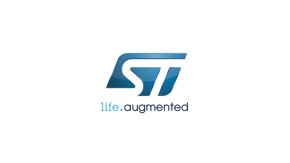

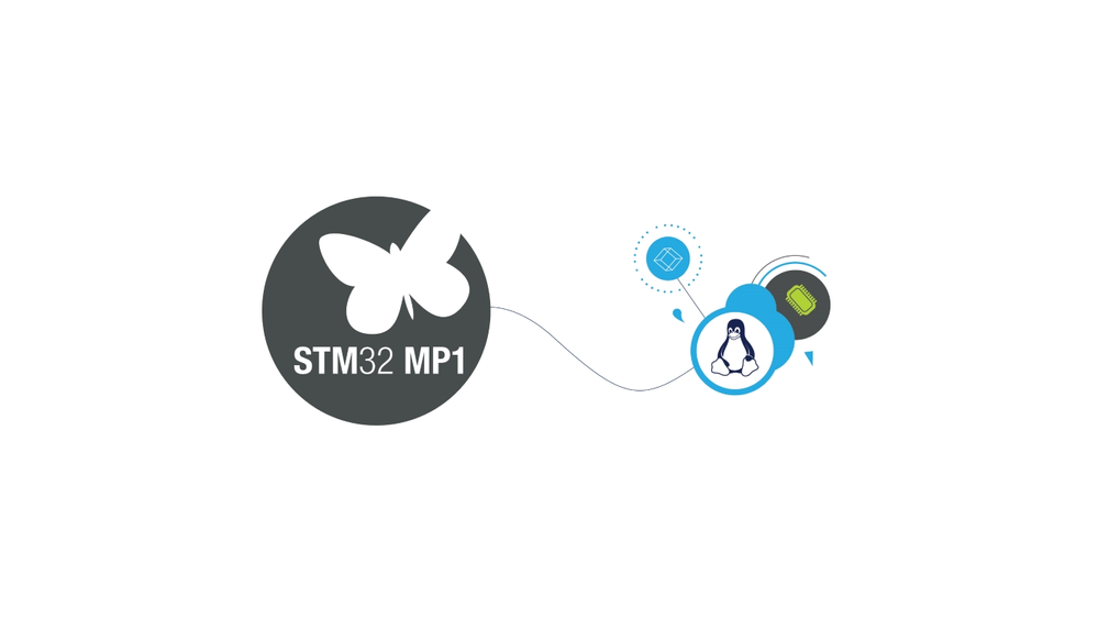

I am evaluate the STM32MP157C-DV2 board.
I have disabled the weston service by referring to the link below.
https://community.st.com/s/question/0D53W00000cSKmXSAW/disable-weston-autostart-in-stm32mp157cdv2
When boot with the weston service disabled
The two images below appear sequentially.
0693W000008xDuvQAE.png0693W000008xDv5QAE.pngI want to customize the boot screen to the image I want.
I found the above images in the path below.
layers/meta-st/meta-st-openstlinux/recipes-graphics/wayland/weston-init/
Although I did find the path of the default boot images,
I think it has nothing to do with weston-init because the weston service is inactive.
The psplash recipe exists in the path below.
layers/meta-st/meta-st-openstlinux/recipes-core/psplash/psplash-drm
layers/openembedded-core/meta/recipes-core/psplash
What recipe do I have to override in my custom layer to change the boot screen?
PatrickF
first image is uBoot splash screen (splash.bin in bootfs I think)
second the Linux one
see section 7 in https://wiki.st.com/stm32mpu/wiki/Getting_started/STM32MP1_boards/STM32MP157x-DK2/Let%27s_start/Populate_the_target_and_boot_the_image
see also https://www.st.com/content/ccc/resource/training/technical/product_training/group1/ac/45/53/56/1f/0b/47/68/STM32MP1-Software-Platform_boot_BOOT/files/STM32MP1-Software-Platform_boot_BOOT.pdf/_jcr_content/translations/en.STM32MP1-Software-Platform_boot_BOOT.pdf
I'm not Linux nor Yocto expert, maybe this one could help:
https://www.youtube.com/watch?v=hqGA5Krk0mU with files in https://drive.google.com/drive/folders/1eHO37VljVpbTt-TBJFZ2-Yack5fZPj-v
Regards.
