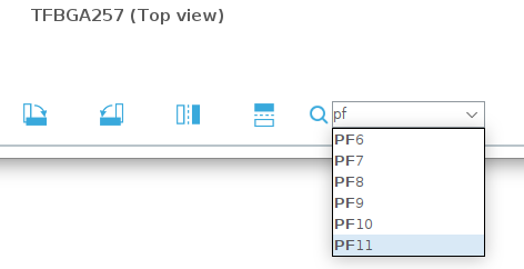

With the new configuration of your board:
 	gpiof: gpio@50007000 {
 		status = "okay";
 		ngpios = <6>;
		gpio-ranges = <&pinctrl 0 80 16>;
means thats :
- pins 80..95 on pin controller "pinctrl" is mapped to GPIO line 0..15
Which is not possible because this package TFBGA257 doesn't have 16 pins mappable to gpiof, but only 6 pins as indicated by the property "ngpios = <6>" and as visible in the datasheet and CubeMx:
While if we look at the default configuration that you had before:
		status = "okay";
		ngpios = <6>;
		gpio-ranges = <&pinctrl 6 80 6>;
means thats :
- pins 80..85 on pin controller "pinctrl" is mapped to GPIO line 6..11
Which is in line with the documentation.

Hello @Moises Araya​ ,
Your problem looks similar to this one: GPIO14,15 cannot be used with STM32MP151DAB (LFBGA354).
There is currently a problem with two packages that are not "full package", where not all of the GPIO are available. It concerns:
stm32mp15xxad-pinctrl.dtsi
stm32mp15xxab-pinctrl.dtsi
And the problem concerns GPIOF and GPIOG, which is also your case.
Please read this post, you will find two patches that will be present in a next release.
Hope it helps,
Regards,
Kevin

Hi @Kevin HUBER​ ,
Thanks for your answer. It is good to know that the problem has been already tackled.
I applied the corresponding UBoot patches but the problem in Linux persists as described above. Are you shure the Linux (5.10.61) driver can deal with GPIO offsets?
If I patch the stm32mp15xxad-pinctrl.dtsi to the following, the available GPIOF and GPIOG pins actually work:
 		status = "okay";
 		ngpios = <6>;
 	gpiog: gpio@50008000 {
 		status = "okay";
 		ngpios = <10>;
		gpio-ranges = <&pinctrl 0 96 16>;
Thanks again!
