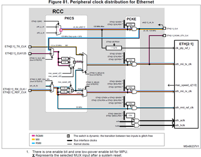

Hello everyone,
i'm working on a custom SOC based on ST32MP135 and LAN8710 ethernet phy chip.
When the HAL_ETH_Init() code runs and sends the module reset by setting the ETH_DMAMR_SWR bit, the loop exits with the HAL_ETH_ERROR_TIMEOUT.
The current interface is set to SYSCFG_ETH1_RMII value and the clock source is set by the following code:
HAL_RCCEx_PeriphCLKConfig(&(RCC_PeriphCLKInitTypeDef){
	.PeriphClockSelection = RCC_PERIPHCLK_ETH1,
	.Eth1ClockSelection = RCC_ETH1CLKSOURCE_PLL4
  The HAL_ETH_MspInit() function sets the GPIOs and enables the clocks:

 Touching the pin 5 (CLKIN) of the PHY I see a 50MHz clock.
Any idea about the timeout?

Hi @SteMMo
this kind of error usually come from lack of clock going to ETH IP (eth_mii_tx_clk and eth_mii_rx_clk).
Apart settings in RCC, please have a look to this figure from RM0475 and set SYSCFG according to your HW board setup to ensure correct clock paths are selected.
AN5474 could also help.
Regards.
