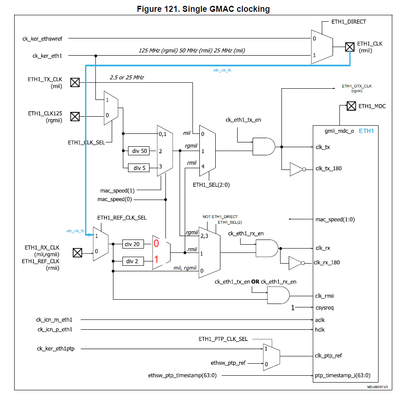

I have a custom board based on STM32MP257FAK3, based on STM32MP257EV1 evaluation board. My board has a rtl8367s ethernet switch connected on eth2 port though rgmii. I can communicate though mdio to the rtl8367s and configure it. We are using OpenWrt kernel and rtl8365mb driver though smi that seems to be the right one.But I can not make works eth2 is failing DMA every time. I will share you my logs and dts. Every idea is welcoming. Thank you!

Hi @PatrickF ,
We confirm that this was the issue. After change rx and tx issue has been solved.
Thank you for your effort.

PatrickF
HI @jcalvo
Beside not using OpenSTLinux kernel (I cannot comment on this as I'm not SW expert), the DMA reset error usually mean the GMAC does not receive the 125MHz clock on its internal RX/TX clocks.
There is many options and multiple clocks which could be either from RCC or from PHY, depending on your HW.
All those need to be setup in DTS.
See https://wiki.st.com/stm32mpu/wiki/Ethernet_device_tree_configuration
See also Reference Manual RM0457 to figure out the clocks paths.
Regards.

Hi @PatrickF,
Thank you for your answer. We had reviewed this clock and seems to be active, I attach our clock configuration:
ck_pll6 500000000 Y
ck_flexgen_54 125000000 Y
ck_ker_eth1 125000000 Y
ck_ker_ethsw 125000000 N
ck_flexgen_55 125000000 Y
ck_ker_eth2 125000000 Y
It's really weird because we had used as base image from bootlin https://bootlin.com/blog/openwrt-support-for-stm32mp-updated-and-stm32mp2-added/ . Here they used stm32mp257ev1 as hardware and have both eth1 and eth2 working. We only replace tfa, optee, uboot and dts kernel files. So I can not understand what is changing. As I comment upper our phy RTL8367s is not generating any 125Mhz clock, but it should be generated by pll6. The only difference is that they are using mp257fai and we are using fak3 version. Idk.
Thank you in advance!

125MHz clock seems enabled, but might not be correctly 'routed' to the ETH2.
https://wiki.st.com/stm32mpu/wiki/Ethernet_device_tree_configuration#RGMII_with_Crystal_on_PHY--no_CLK125_from_PHY_-28Reference_clock_-28standard_RGMII_clock_name-29_CLK125_is_provided_by_a_RCC_SoC_internal_clock-29
at first look you might miss at least:
       st,ext-phyclk;
https://github.com/STMicroelectronics/linux/blob/v6.6-stm32mp/Documentation/devicetree/bindings/net/stm32-dwmac.yaml#L88
Regards.

[    1.616357] stm32-dwmac 482d0000.eth2: Using 32/32 bits DMA host/device width
[   20.325214] stm32-dwmac 482d0000.eth2 eth1: Register MEM_TYPE_PAGE_POOL RxQ-0
[   20.327231] stm32-dwmac 482d0000.eth2 eth1: Register MEM_TYPE_PAGE_POOL RxQ-1
[   21.340534] stm32-dwmac 482d0000.eth2: Failed to reset the dma
[   21.340800] stm32-dwmac 482d0000.eth2 eth1: stmmac_hw_setup: DMA engine initialization failed
[   21.352384] stm32-dwmac 482d0000.eth2 eth1: __stmmac_open: Hw setup failed

proposal on your side is to check if values of SYSCFG_ETH2CR are ok with your platform setting Vs RCC ethernet clock figure.
With what you mention, you should have:
  • ETH2_SEL[2:0] = 1 (RGMII)
  • ETH2_CLK_SEL and ETH2_REF_CLK_SEL = 1 (125MHz clock from RCC)
If this is ok, maybe you should have a look to STM32MP257F-DK device tree (although we use 125MHz from PHY on this board, other settings related to ethernet might help you).

jcalvo
Hi @PatrickF,
Thank you for your thoughs. We have checked and SYSCFG_ETH2CR is taking value 0x16 instead of 0x17. So ETH2_REF_CLK_SEL is taking 0 as value. Despite we have tryied differents flags from documentation that you had provided nothing changed. Register value continue to be 0x16. We noticed that some flags are marked as obsolet. What are the correct ones?
Thank you!

Sorry, It is normal to have ETH2_REF_CLK_SEL=0 in RGMII. forget my previous information.
Maybe check why there is no RX_CLK 125 MHz from the external PHY to the ETH1 (if there is clock on the pin, please check pinmux).
in the log, I see some mixed eth2 and eth1, which might be normal, but worth to double check.
I fear I cannot help more.

jcalvo
Hi @PatrickF,
After giving it some thought, we determined that there’s a hardware mistake. Basically, RX and TX are swapped.
We assumed it was the same as the RTL8211F (the other Ethernet controller we have), but according to the datasheet, they’re reversed — what is described as an output on one is an input on the other, and vice versa.
I honestly don’t understand the mess in Realtek’s documentation.
But this must be the problem. We’re going to try swapping the signals, and hopefully tomorrow we’ll have a clearer picture.
Thank you for your effort and time!
jcalvo
Hi @PatrickF ,
Best regards,
Javier.
