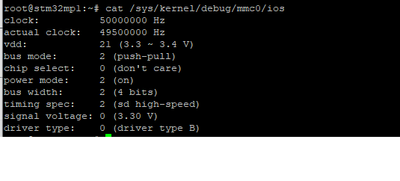

The first logo appears, but the display behind it does not work. Looking at the error message below, it seems like there is a problem with ext4. How can I solve it? Or did something go wrong?

[ 310.232669] EXT4-fs (mmcblk0p8): error count since last fsck: 2
[ 310.237259] EXT4-fs (mmcblk0p8): initial error at time 1677836966: ext4_wait_block_bitmap:532
[ 310.245827] EXT4-fs (mmcblk0p8): last error at time 1677836966: ext4_wait_block_bitmap:532
[ 315.352674] EXT4-fs (mmcblk0p9): error count since last fsck: 2
[ 315.357291] EXT4-fs (mmcblk0p9): initial error at time 1677836966: ext4_wait_block_bitmap:532
[ 315.365791] EXT4-fs (mmcblk0p9): last error at time 1677836966: ext4_wait_block_bitmap:532

Christophe Guibout
Hello @LeeJaewon,
According to the logs, it seems you use STM32MP157F Disco board, but the atteched picture shows a custom board : could you please elaborate the hardware you use ? And what about the SW Ecosystem version ?
It seems linux is not able to read the filesystem, nevertheless, tf-a has been able to load the fip with u-boot, and u-boot has been able to load bootfs partition to load the kernel, so the sdcard is not fully dead.
I would recommand to reflash the sdcard (if it's a sdcard) or change it with a new one ?
Otherwise, I would enable MMC debug (wiki link)
BR,
Christophe
Hello, I developed a custom board with a pinmap based on stm32mp157f - dk2.
I think if you match the pinmap and use the start package, lcd and other features will work.
I re-created the sd card according to that advice, and I also rebooted it, but the same thing is happening.
What should I do?
