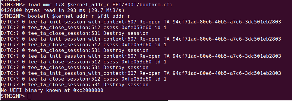

Good morning, I've been trying to get EFI boot working from emmc. After configuring flash layouts to contain fat32 efi partition and getting through uboot and optee configuration to properly flash using cube programmer, I can't seem to figure out why the uboot fails to load the EFIed kernel during boot process. Screenshot from 2024-04-02 13-54-29.pngIt would seem as if the kernel image is missing the efi stub, but my kernel config would suggest otherwise.
Any ideas on how to get the EFI boot to work?

Hello @Erwan SZYMANSKI ,
I am building from yocto environment. And my uboot efi config looks like this:

and my kernel config
CONFIG_EFI=y
CONFIG_EFI_STUB=y
CONFIG_EFI_VARS=y
CONFIG_EFI_VARS_PSTORE=m
CONFIG_EFI_CAPSULE_LOADER=m
# Systemd
CONFIG_EFIVAR_FS=y
CONFIG_EFI_PARTITION=y
# efi
CONFIG_EFI=y
CONFIG_EFI_STUB=y
CONFIG_EFI_VARS=y
CONFIG_EFI_VARS_PSTORE=y
CONFIG_EFI_CAPSULE_LOADER=y
CONFIG_EFI_GENERIC_STUB_INITRD_CMDLINE_LOADER=y
CONFIG_EFI_BOOTLOADER_CONTROL=y
# needed for lttng-modules
CONFIG_KPROBES=y
CONFIG_KALLSYMS_ALL=y
CONFIG_TEE=y
CONFIG_OPTEE=y
CONFIG_RELOCATABLE=y
CONFIG_EFI=y
CONFIG_EFI_STUB=y
CONFIG_X86_SYSFB=y
CONFIG_FB_SIMPLE=y
CONFIG_FRAMEBUFFER_CONSOLE=y
CONFIG_EFIVAR_FS=y
CONFIG_EFI_MIXED=y
I do have MACHINE_FEATURES += "efi" in my machine configuration
