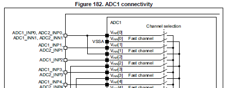

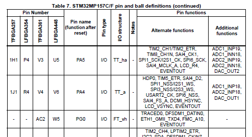

I agree ADC connections are quite complex to fully master.
Best for this ADC pin choice is to use CubeMX.
You could find information in Product Reference Manual, ADC section
e.g.
_legacyfs_online_stmicro_images_0693W00000bkCAIQA2.pngtogether with Product Datasheet pin list, looking in additional function column
_legacyfs_online_stmicro_images_0693W00000bkCAXQA2.pngRegards.

Thank you. That actually makes perfect sense. They are all analog capable, as it's just a setting to lower power. However, to read actual analog signal they must be attached to an internal ADC peripheral. The datasheet is sparse. However, the Reference Manual has quite a bit of information about GPIOs. What I don't see is an indication about what GPIO inputs might have an ADC backend. But I'm not sure what exactly I am looking for in that regard.
e.g.
Tip of the day: Try Sidekick STM32 AI agent, see here
Thank you. That helped me determine what I was looking for in the datasheet!
