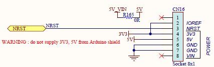

I am working with stm32mp157-dk2.
Arduino connector CN16-pin5 is giving 5v.
How can I switch on/off this pin in my M4 program ?
I couldn't find a solution or example, could you please help me ?
PatrickF
This pin is tied to 5V_VIN (VBUS supply from USB Type-C connector CN6) thru a 0ohm resistor. No way to switch off by SW.
This 5V is present on all Arduino.
On STM32MP157-DK2, in case of conflict with your Arduino shield, you could disconnect it permanently by removing R165 (visible on PCB close the the 5V CN16 pin).

PatrickF
