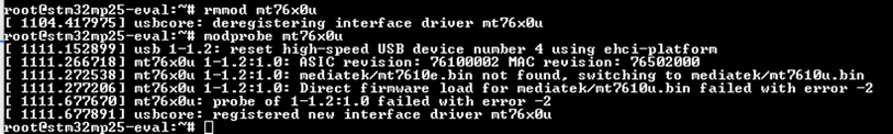

I updated the kernel image on board. However, when I plug in the dongle I get the error:

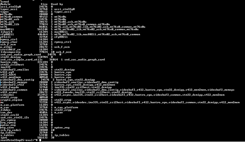

It looks like all necessary modules are present:
I tried to restart the module, same result:

Thank you, @PatrickF for your reply.
Indeed, I'm missing mt7610e.bin and mt7610u.bin, but where do I get them? I've followed the instructions in example of Modifying kernel configuration in How to cross-compile with the Distribution Package, and as a result I got a new kernel image and relevant library files. No xxxxxx.bin files were created (or I couldn't find them), and nothing was mentioned about xxxx.bin files. How to get these files short of copying them from another system?
Actually, I created folder /lib/firmware/mediatek and copied mt7610e.bin and mt7610u.bin from RaspberryPi I have. After that I was able to load the driver and bring-up WiFi interface. It worked, but it does not feel like a proper way to do.
