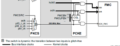

See also clocking, if not used by any driver, Linux will not enable the IP clock.
https://wiki.st.com/stm32mpu/wiki/STM32MP15_clock_tree#Device_tree_2
Try also
cat /sys/kernel/debug/clk/clk_summary
Notice that FMC has multiple clocks (bus clock and a kernel clock). I think all should be enabled to access registers.

Hi @PatrickF .
As I am working with 4.19 version of linux kernel, it is not enough to enable fmc in device tree. The driver will quit at probe function when no nand device detected. The registers will be unmapped then, that is why I cannot access its registers.
