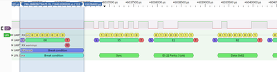

I am trying to write a LIN master for STM32MP135 running a Yocto Linux. Currently, I am struggling with the break signal. According to the LIN specification, it has to be at least 13 (up to 20) bits long. The device I am trying to talk to is using 9600 baud and the break signal is 1340μs there:
A LIN tranceiver is connected to USART1 on my board. How can I send the correct break signal on USART1 on Linux?
