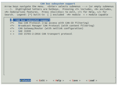

I am trying to see if I can enable the J1939 protocols on the stm32 mp158d-dk1 board. I used the menuconfig to update the setting.
After doing that I updated the uimage, dtb, and modules to the stm32 mp1 device.

I can see that SAE J 1939 protocol is active. I used the following headers to read from the linux user land.
#include<linux/can/j1939.h> // I got no errors with the header file.
#include <sys/ioctl.h>
#include <sys/socket.h>
#include <linux/can.h>
#include <linux/can/j1939.h>
#define MAX_CAN_DLC 8
int main() {
    int sock;
    int ret;
    struct sockaddr_can sockname;
    struct sockaddr_can peername;
    socklen_t peernamelen;
    struct ifreq ifr;
    uint8_t dat[128]; // Buffer to hold the received data
    int value = 1;    // Enable promiscuous mode
    // Open a socket for J1939 protocol
    sock = socket(AF_CAN, SOCK_DGRAM, CAN_J1939);
    if (sock < 0) {
        perror("Socket creation failed");
        return 1;
    // Specify the CAN interface (e.g., "can0")
    strcpy(ifr.ifr_name, "can0");
    ret = ioctl(sock, SIOCGIFINDEX, &ifr);
    if (ret < 0) {
        perror("ioctl failed");
        close(sock);
        return 1;
    printf("CAN interface index: %d\n", ifr.ifr_ifindex);
I was wondering if anyone has success with j1939 protocol. I tried doing it, but I don't see any decoded frames in the user land.
Did anyone have success with J1939? If not I am planning to just use the regular CAN for my application.
