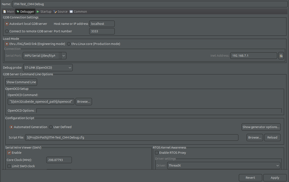

I’m using an STM32MP157F-DK2 board and trying to use one of the Cortex-M4 debugging features — ITM (Instrumentation Trace Macrocell).
However, I’m receiving garbage values on the SWV console, and I’m not sure why.
Here’s what I’ve done so far:
  • Edited the int _write() function in syscalls.c to redirect output to ITM
  • Enabled Serial Wire Viewer (SWV) in the debug configuration.Screenshot from 2025-10-28 11-28-45.png
  • Set the core clock frequency in the debugger to match the MCU clock (as configured in the .ioc file).
These are the typical steps I follow to enable ITM output.
Is there anything else required to get correct SWV output?
Am I missing any configuration or initialization step specific to the STM32MP1 series?
