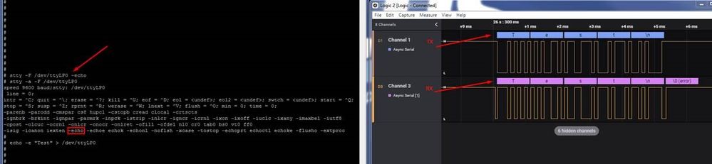

I'm working on a driver present in the Linux 5.4 kernel. In RS485 communication I receive everything I send, without being connected to another device to return what I sent.
I use the command echo -e "Test" > /dev/ttyLP0 for the submission.
I know that by default in RS485 communication I receive everything I send, but I want to disable the return (echo).
BUG:
0693W00000KbhsAQAR.jpgMy setup is:
PLC - Programmable Logic Controller
Processor: LS1027 (It's not a ST processor)
Linux Kernel 5.4 (tty driver present in this kernel version, who owns the stm32-usart.c)
I use a USB logic analyzer to analyze the signal sent through the echo -e "Test" > /dev/ttyLP0. With rs485 serial pins: D+, D- and GND.
