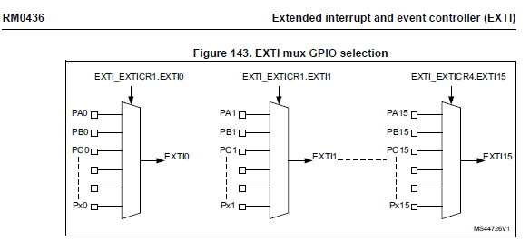

I'm trying to control GPIO input in own application.
and I refered to below wiki.

When I run application, 3 input pins (PE9, PG9, PD12) return error like below.
Failed to issue GPIO_GET_LINEEVENT_IOCTL (-19)
And the kernel log printed as below.
[ 5366.798479] stm32mp157-pinctrl soc:pinctrl@50002000: irq line 9 already requested.
[ 5366.812031] stm32mp157-pinctrl soc:pinctrl@50002000: irq line 9 already requested.
[ 5366.825262] stm32mp157-pinctrl soc:pinctrl@50002000: irq line 12 already requested.
below is my gpio info of these pins.
line   9:        "PE9"       unused   input  active-high
line   9:        "PG9"       unused   input  active-high
line  12:       "PD12"       unused   input  active-high
Where should I check to solve this problem?

PatrickF
Please note that there is a inherent HW limitation in EXTI (common to most STM32 products) that there is only 16 GPIO interrupts and only one interrupt EXTIx could be set for all port with same index Py[x].0693W00000WLWPXQA5.pngSee also https://wiki.st.com/stm32mpu/wiki/EXTI_internal_peripheral
You should align your overall GPIO EXTI interrupt choices to this HW constraint.

Hello @hochul yoo​ ,
It is highly possible that the 3 gpios that you are asking for are already reserved for other IPs. For example, if you take a look at the device tree stm32mp15xx-dkx.dtsi file, you can see that gpio PG9 is used by cs42l51 node.
In this case, you have 2 choices. Use another GPIO or disable the node if you do not use the specific feature.
