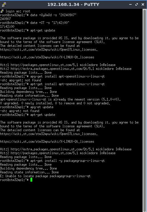

E: Unable to locate package packagegroup-x-linux-qt
DMårt
Lead
I tried to install QT
apt-get install -y packagegroup-x-linux-qt
But I got the error
I have followed this
https://wiki.st.com/stm32mpu/wiki/X-LINUX-QT_Expansion_Package
STM32MP151AAC3 custom board with STM32-OS as operating system: https://github.com/DanielMartensson/STM32-Computer
STM32MP257FAK3 custom board with STM64-OS as operating system: https://github.com/DanielMartensson/STM64-Computer

Hello Daniel,
Would you please try again now and make sure you have executed the below commands in the right order ?
date +%y%m%d -s "20250101"
date +%T -s "00:00:00"
wget -q --spider http://google.com && echo "Online" || "Offline !!"
apt-get update
apt-get install -y apt-openstlinux-x-linux-qt
apt-get update
systemctl restart weston-graphical-session.service
I succeeded to install the x-linux-qt packages on my STM32MP25-EV1 board connected to the internet thru the ETH1 connector.

Hi @Karim BEN BELGACEM
Still the same error as above. I think there might be an issue with the apt-get?
Notice that I'm using STM32MP1 starter package. Not STM32MP2 starter package.
Hi Daniel,
Starter Package for MP1 is not yet distributed. You will need to start from the X-LINUX-QT Distribution Package for the MP1 devices, then build the full image for it.
Please note that MP1 devices are still under testing internally so performances are not fully guaranteed to match the expected ones.
Best Regards,
Karim
@Karim BEN BELGACEM
So I need to build a Yocto Project with QT package from ST?
Yes, the STM32MP1 distro is very buggy. I think I will work for fitting a regular Linux distro for the STM32MP1 processors.
