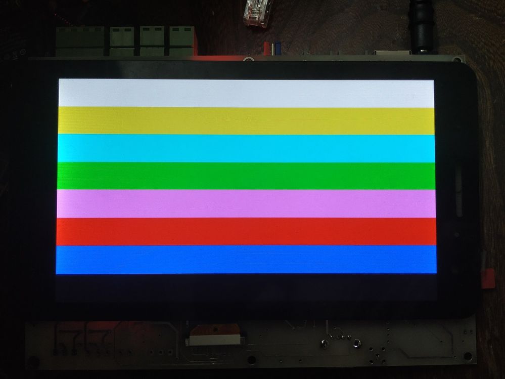

0693W000006HTZrQAO.jpgTo prove all the timings is Ok I enabled the DSI host test pattern generator. Which is explained in “36.11.1 Color bar pattern�? of DSI Host (DSI) of RM0436 Reference manual of STM32MP157.

 The result is shown in bellow picture:

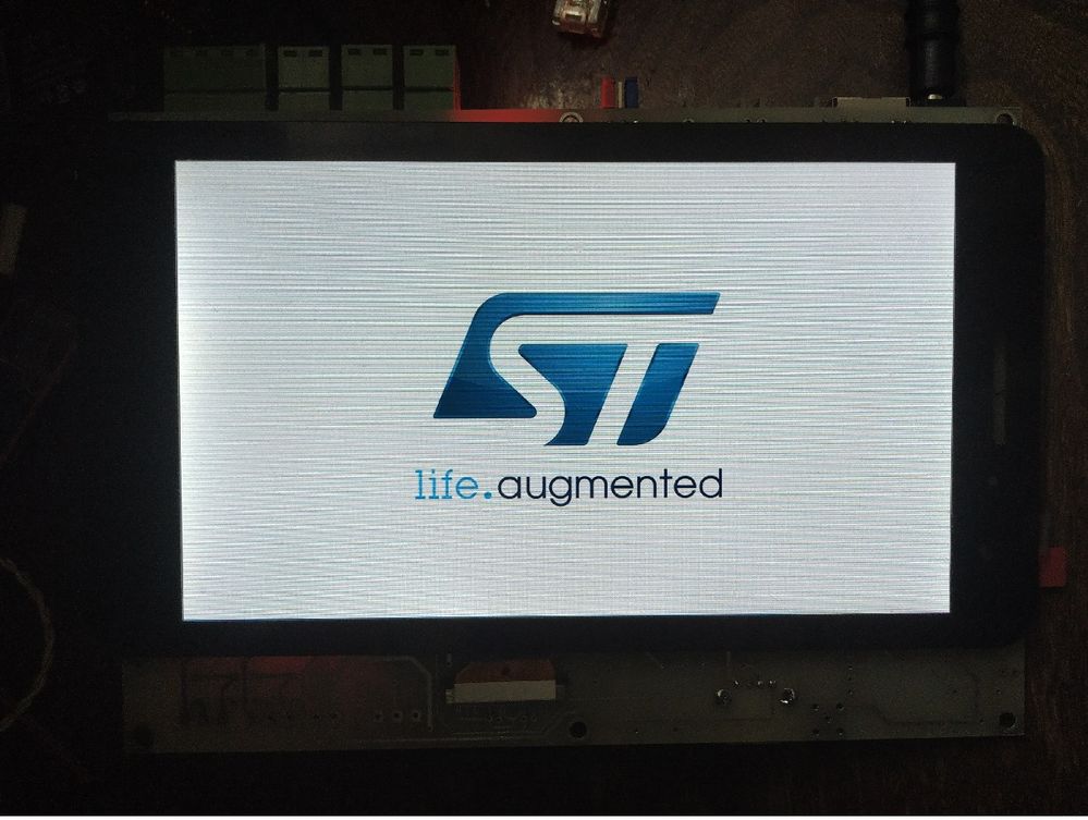

0693W000006HTaLQAW.jpgThe panel mode structure is as bellow, [based on TV070WSM-TL0 datasheet].

 I tested the lower refresh rate, with RGB888 and RGB565 and …. Which all works in u-boot, but not in kernel.
