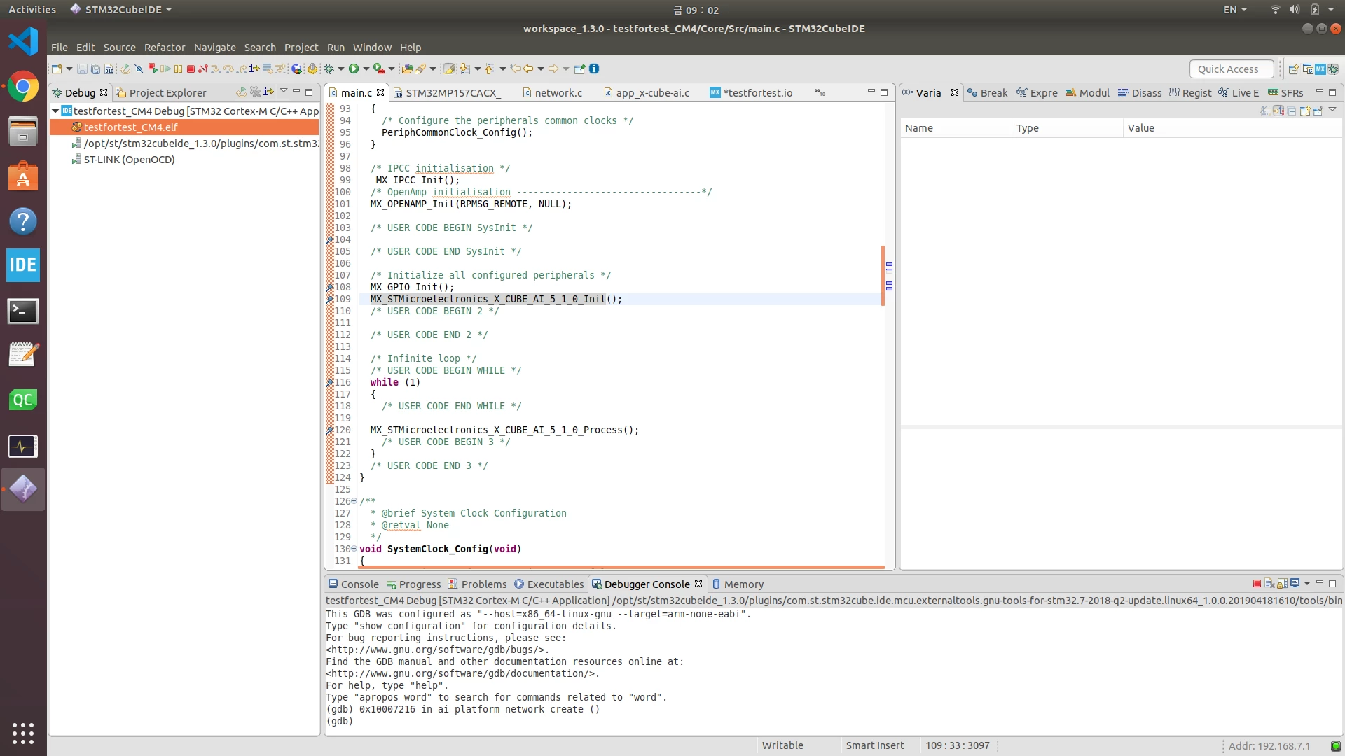

A project created by X-Cube-Ai 5.1.0 on STM32MP157-DK2 is stuck in an infinite loop.
  • June 12, 2020
  • 1 reply
  • 2237 views
I just made a pure x-cube-ai project with no user code included, and it is stuck at creating network object... I couldn't analyze this problem because it seems to be related to the network library.(prefix .a). Willing to help me out?

You need to enable CRC2 on the CortexM4 context of the MP1 to make it work
As of today systemperformance and validation on the target only works in engineering mode as they require a USART connection to the host via the stlink.
