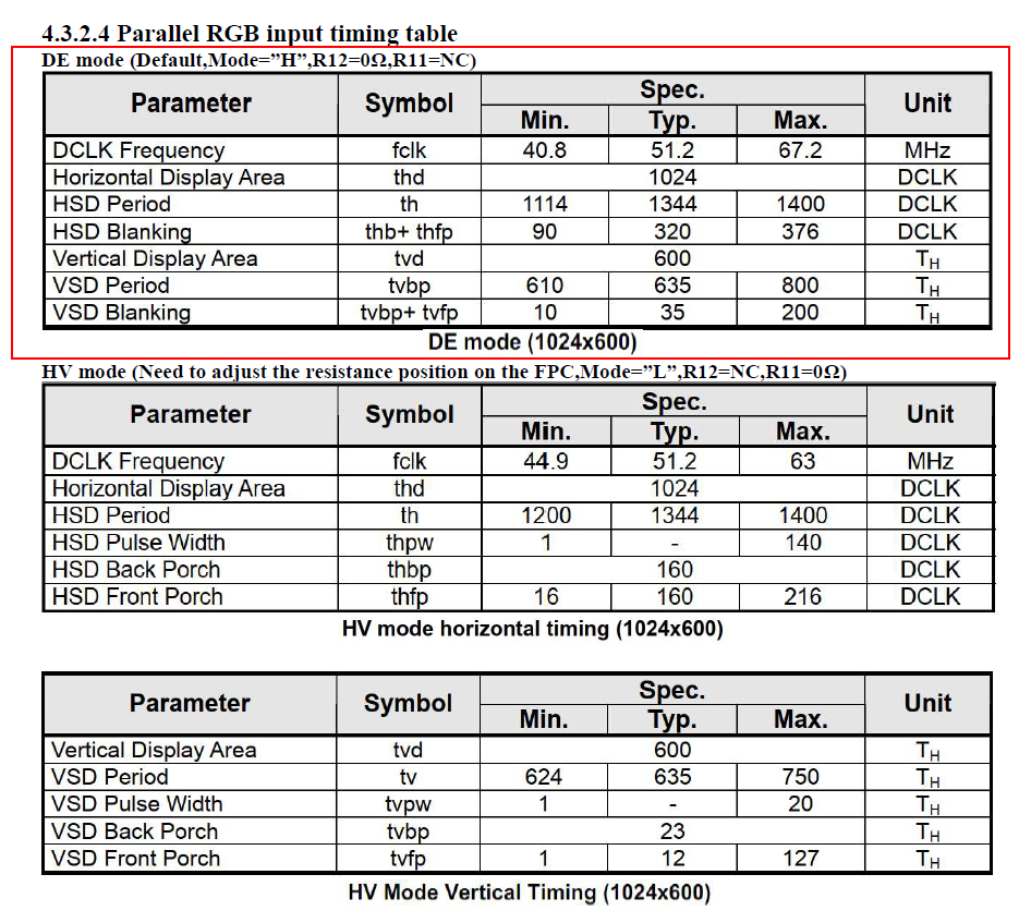

Regard to display timings, in my case the display works in "DE mode". If I well understood in this working mode the HSINK e VSINK signals are internally generated by the display, is this correct? If this is correct, I don't know if the HSINK and VSINK signals have to be managed by the LCD controller or have to be set as I/O pins.
Regard to hfront-pork, hback-pork, vfront-pork, vback-pork timings value, the display datasheet doesn't indicate any value for this timings if the "DE mode" is set (see image below) so I set them to 0.

Anyway for the timings. In the worst case, if they are bad, you will be able to change it after easily in the DT. I think the first step for you is to ensure that you are able to probe properly your panel, and that you can detect it from the Linux world.
As soon as this step is successful, if you have timing issue, you will see artifact or bad rendering on the screen, but it will mean that the Linux Graphic stack/framework has everything properly configured to work.
