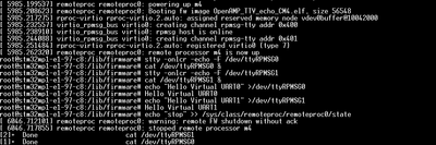

shivam203
Hi @Tom18 ,
You can take reference from the application which is present on this location:
STM32Cube_FW_MP1_V1.7.0\Projects\STM32MP157C-DK2\Applications\OpenAMP\OpenAMP_TTY_echo
On running the project present of this location, I got these logs.
Thank you
