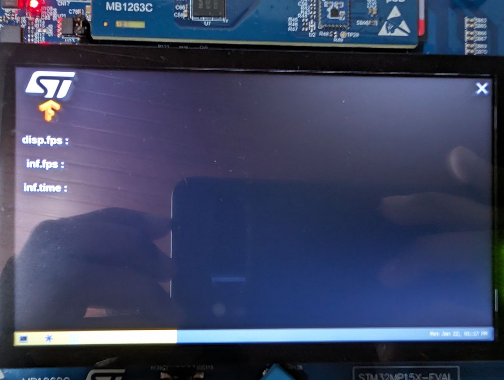

I was using an STM32MP157F-EV1 evaluation kit and followed the instructions mentioned in https://wiki.st.com/stm32mpu/wiki/X-LINUX-AI_Starter_package#Configure_the_AI_OpenSTLinux_package_repository and installed the AI OpenSTLinux package. I then proceeded to X-Linux-AI sample AI applications. The demos appeared on the onboard display on the evaluation kit.
I tried opening the applications using the touch interface as well as the command line. Example https://wiki.stmicroelectronics.cn/stm32mpu/wiki/TFLite_Cpp_object_detection
In both cases the application loads but there is not input from the onboard camera.
I tried copying some test images onto the testdata folder and running the application to detect the static images. This works fine.
The demo camera app on the demo launcher works fine as well. But none of the AI demo applications are able to use the stream from the camera.
Below are a few things I tried.

In all these cases The display shows the same thing as shown in image above.
How do I get the app to work with the camera?

‎2024-01-25 2:05 AM
Hey,
I believe the sample AI application supports different framerates and image sizes. But I think the problem is with the camera specifications. I got it to work with the following command:
/usr/local/demo-ai/computer-vision/tflite-object-detection/bin/objdetect_tfl_gst_gtk -m /usr/local/demo-ai/computer-vision/models/coco_ssd_mobilenet/detect.tflite -l /usr/local/demo-ai/computer-vision/models/coco_ssd_mobilenet/labels.txt -v /dev/video0 --frame_width 320 --frame_height 240 --framerate 30
The framerate can be changed, but anything above 13FPS gets capped to 12.8 fps automatically.
But, the width and height must be 320x240. Anything higher and the stream fails to load.
I referred this post to find the solution: https://community.st.com/t5/stm32-mpus-boards-and-hardware/no-video-stream-for-python-c-od-demo-with-coco-ssd-mobilenet-v1/td-p/626556
The person who made that post says he got it working with 640x480 with a low FPS on his board. But it didn't work for me.
He also mentions the streaming limitation does not occur when using a USB camera. Need to check that out.
