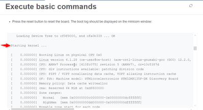

Hello all,
I was trying to build Linux kernel and push into my STM32MP135F-DK. For this, I was following the steps below link (Modify, rebuild and reload the Linux® kernel):
https://wiki.st.com/stm32mpu/wiki/Getting_started/STM32MP1_boards/STM32MP135x-DK/Develop_on_Arm%C2%AE_Cortex%C2%AE-A7/Modify,_rebuild_and_reload_the_Linux%C2%AE_kernel
Nothing seemed wrong to me until "5.4. Reboot the board" step. After I rebooted the board, only the ST logo appears for a while, then it disappears and a black screen appears for a few seconds, then the ST logo appears again. This loop continues constantly and never switches to other screens (Linux splash screen, Weston desktop, GTK demo launcher).
I have no idea why I experienced such a thing since everything seemed correct until the reboot step. I wondered if I had pushed the wrong device tree in the "5.2. Push the device tree into the board" step in the link above (since I was using STM32MP135F-DK, I pushed the stm32mp135f-dk.dtb one). But I am not sure.
Can you help me?
Best answer by Gregory PLANCHON
Hi @alpka ,
Your dt is not deleted, the system just can't find it.
In order for your board to boot correctly, all your boot stages must be aligned with each other.
You can find the versions of the different systems used in several places in the wiki:
    in the release notes : https://wiki.st.com/stm32mpu/wiki/STM32_MPU_OpenSTLinux_release_note_-_v5.0.0#Release_content
    in the developer package : https://wiki.st.com/stm32mpu/wiki/STM32MP1_Developer_Package#Installing_the_OpenSTLinux_BSP_packages
    and in the wiki archives for older versions like 4.1 : https://wiki.st.com/stm32mpu/wiki/Wiki_archives
Finally, you don't need a new SD card, you just need to reflash it with a starter package to get the software working again.
Regards,
Grégory

Hi @alpka ,
Have you tried looking at the boot traces (using minicom or putty for example) to see if there was an error message?
And if so, could you please share them with me?
Regards,
Grégory
alpkaAuthor
June 10, 2024
Hi @Gregory PLANCHON,
Here are the traces:

## Booting kernel from Legacy Image at c2000000 ...
 Image Name: Linux-6.1.28
 Created: 2024-06-10 6:48:56 UTC
 Image Type: ARM Linux Kernel Image (uncompressed)
 Data Size: 8212864 Bytes = 7.8 MiB
 Load Address: c2000040
 Entry Point: c2000040
 Verifying Checksum ... OK
## Flattened Device Tree blob at c4000000
 Booting using the fdt blob at 0xc4000000
 XIP Kernel Image
 Loading Ramdisk to ce38d000, end cffff252 ... OK
 Loading Device Tree to ce37a000, end ce38c339 ... OK
gc2145@3c node not found - DT update aborted
Starting kernel ...

E/TC:0 Panic 'Watchdog' at core/drivers/stm32_iwdg.c:105 <stm32_iwdg_it_handler>

When we compare the traces with the below one (which I took from "Execute basic commands" page), things are different starting from  "Starting kernel ..." section:
But I still don't understand what caused this problem, since I did everything according to the "Modify, rebuild and reload the Linux® kernel" page.
Thanks.
