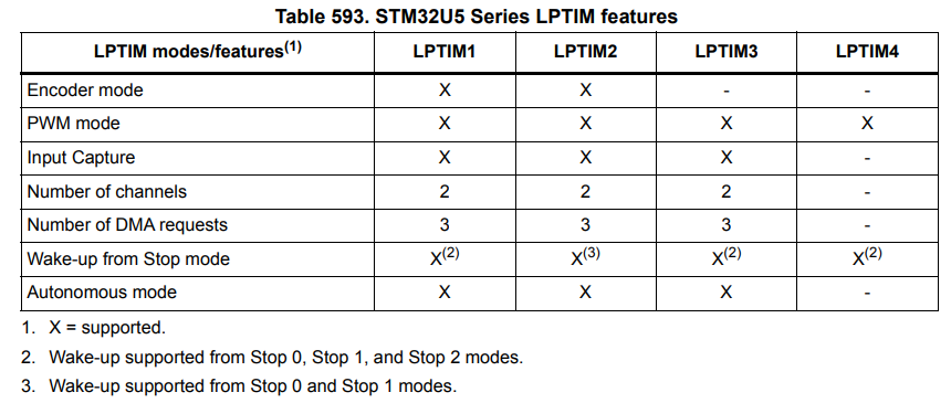

1. Using LPTIM2 instance
As stated in the STM32U5 reference manual, LPTIM2 is only functional in stop 0/1 modes:
STM32U5 LPTIM featuresSTM32U5 LPTIM features

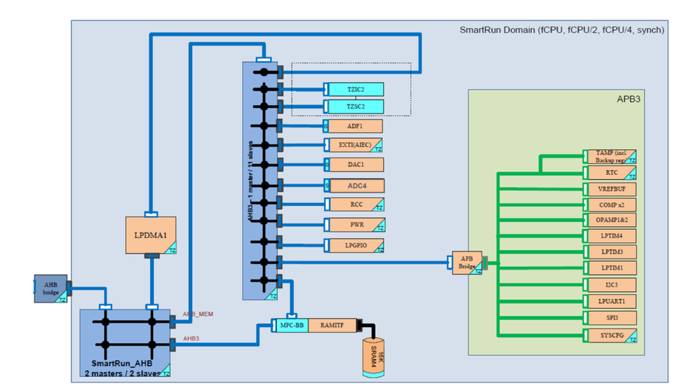

This is because in the smart run domain (SRD), only LPTIM1,3,4 are autonomous, having their own independent clock (kernel clock) request capability. They automatically switch on when requested by a peripheral and switches off when no peripheral requests it. This autonomous feature enables these peripherals wake up the device from stop 2 mode.Smart run domainSmart run domain
