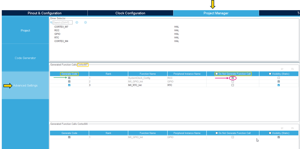

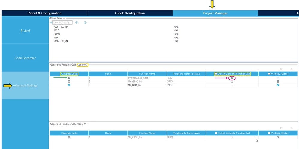

3.1 STM32CubeMX configuration change
In STM32CubeMX, the modification is shown in the picture below:
In "Project Manager" → "Advanced Settings", the SystemClock_Config function is always listed under the Cortex®-M7 section. The checkbox on the left indicates that the function code is generated in the Cortex®-M7 main.c file. No alternative is provided here.
However, it is possible to check the box on the right to prevent the function from being called.
At this point, no further action can be taken on the Cortex®-M4 side.
After code generation, the SystemClock_Config function is not called in the Cortex®-M7 main.c file, but still appears in the function prototypes:
static void MPU_Config(void);
And the code is implemented:

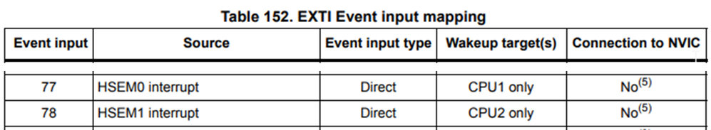

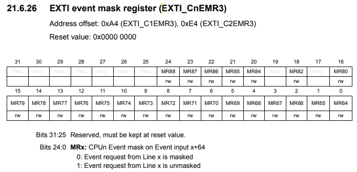

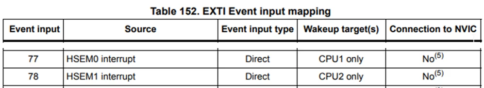

2. By configuring an external or internal EXTI line in event mode, which involves unmasking the event input by setting the corresponding bit in the EXTI_CnEMR event mask register.
 /* Enable CortexM7 HSEM EXTI line (line 78)*/
 EXTI_D2->EMR3 |= 0x4000UL;
In the current case, the event is triggered by the hardware semaphore HSEM to the Cortex®-M4 (CPU2). The corresponding EXTI line number is 78 as shown in the Reference Manual.
The EXTI line 78 event is unmasked in the EXTI_C2EMR3, which is event mask register 3 of CPU2.
