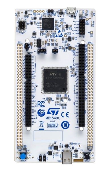

For this tutorial, a NUCLEO-U575ZI-Q with an STM32U575ZIT6Q will be used, but the steps should be the same for any STM32U5, with very minor adjustments.

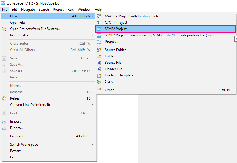

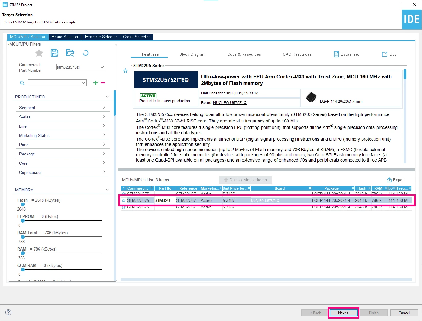

1. Click on File -> New -> STM32 Project
2. In the STM32 Target selector, find for you microcontroller, you can type the part number to easy navigation, then click NEXT. In our case the STM32U575ZIT6Q will be used.

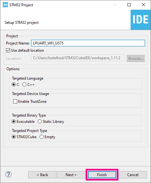

3. Give a name (avoid special characters and space) for your project and click FINISH:

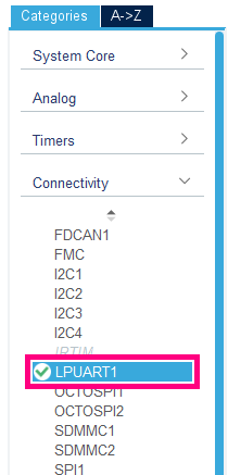

4. In the list, look for CONNECTIVITY -> LPUART1:

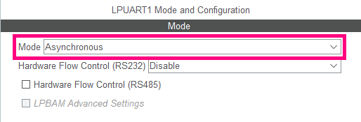

5. Change the LPUART Mode to ASYNCHRONOUS using the drop-down list:

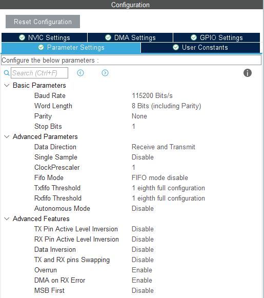

6. The peripheral settings can be left as default, but you can freely change to accommodate your application's necessity (just make sure to select a Baud Rate compatible with your clock settings selection, refer to the MCU Reference Manual for more details).

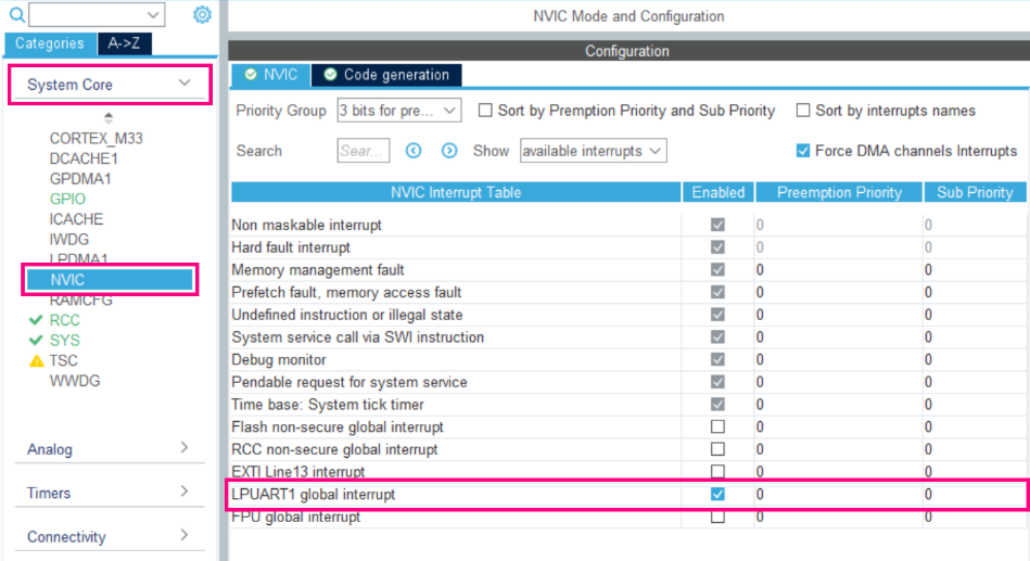

7. We should enable the LPUART1 GLOBAL INTERRUPT at NVIC. For this, open the System Core -> NVCI, then enable the respective interrupt:

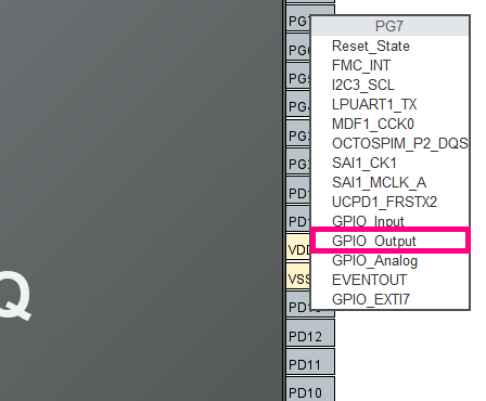

8. Now, configure the PG7 as GPIO_Output (this step is optional, it PG7 is tied to the LED available on the Nucleo Board). We will use the name LED_BLUE in the code as a macro relating the GPIO:

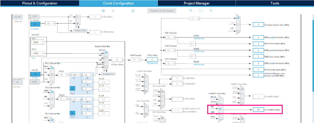

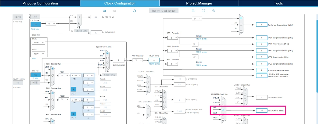

9. Select the LPUART1 Clock Source in the CLOCK CONFIGURATION tab. You can only select the LSE, HSI or MSIK source, because only these are able to maintain the LPUART working in the Stop 2 Mode. In this example, you can select the HSI or the LSE (please be aware that whenever using the LSE as the clock source, the LPUART Baud Rate upper limited is 9600).

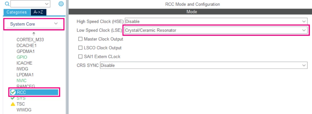

9.1 OPTIONAL: If you’re planning to use the LSE, don’t forget to enable the crystal at System Core -> RCC selecting the Crystal/Ceramic Resonator setting at Low Speed Clock (LSE) drop-down list:

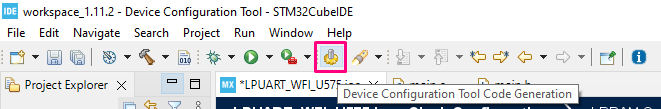

10. Now, all the settings are done. You can generate the code, clicking on DEVICE CONFIGURATION TOOL CODE GENERATION, or using the Alt + k shortcut for it.

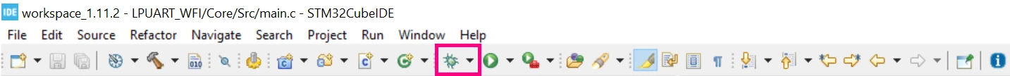

19. Now, all the code implementations are done! You should be able to compile properly, program and debug your code clicking on the debug button:
20. The LPUART1 isn’t connected to the ST-LINK VCOM in the NUCLEO-U575ZI-Q. To make this communication line available, you can connect the PG7/PG8 to an USB bridge or change the solder bridge configuration, as the table below shows (for more details, refer the Nucleo board User Manual):

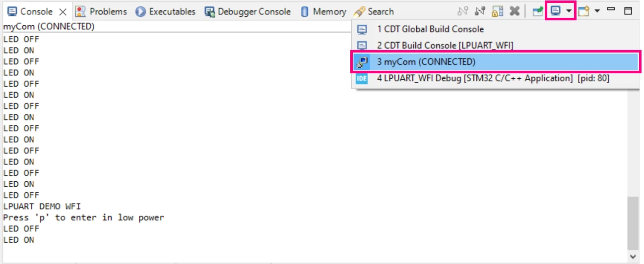

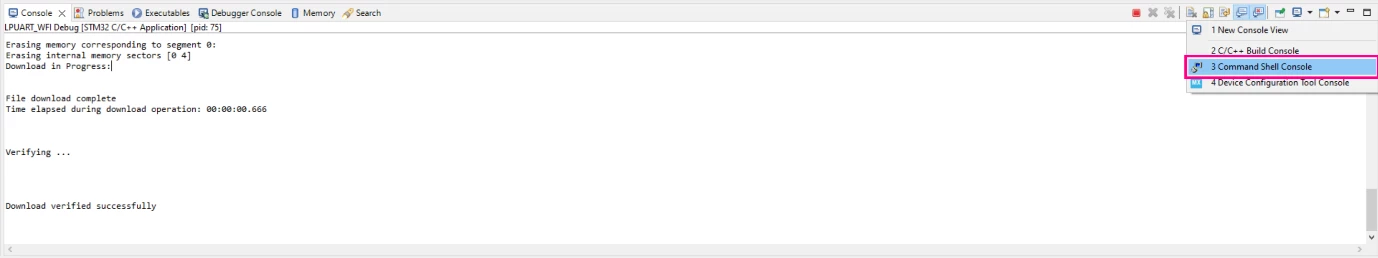

21. To open a Virtual COM into the STM32CubeIDE Interface, click on the button shown in the image below (this button is in the right side of the Console view tab), then clink on Command Shell Console:

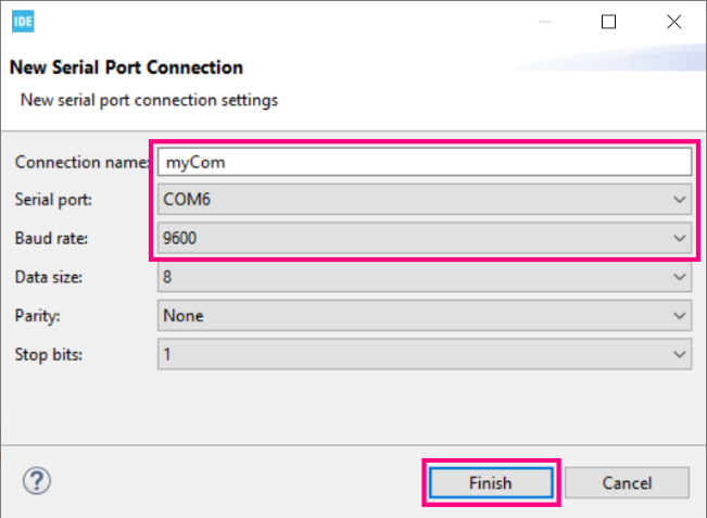

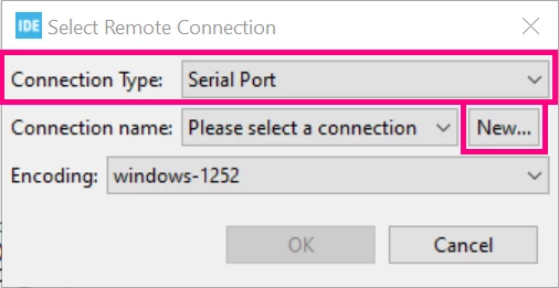

22. In the pop-up menu, select the Serial Port  at Connection Type drop-down list, and click on New… :
23. Give any connection name, select your respective Serial Port, change the Baud Rate, then click on Finish:
24. Click on OK button in the new window, and check that a COM Console was opened (if the tab didn’t show up or was closed, you can open it from the highlighted button). Once the VCOM is connected, press RESUME and you should see the messages in the terminal
Code Explanation:
Running the code, the Blue LED should start to blink and the “LED ON” and “LED OFF” message should be sent through the LPUART. If you type the letter “p” the MCU should be enter in Stop 2 Low-power mode and the blink LED will stop. To wake up the MCU you can send any character via terminal to the LPUART, as result the code will resume back to be executed.
