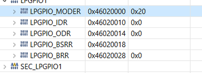

Gautham19
@Sarra.S  I have tried it with Nucleo board u575, when tried to debug. When the code reaches the
MX_LPDMA1_Init(); the debugger connection is lost and no response I tried to track the pin PA1 pin with logic analyzer but pin state is not toggled.
Sarra.S
Hello @Gautham19
Make sure debug pins PA14 and PA13 are not set to analog.
Then reset your board and try stepping through the code
Gautham19
Hello @Sarra.S ,
Thanks for the debug pin configuration . I made changes with the Debug pin, it is set as analog earlier now I changed to Debug pin.
But the pin toggle is not working, it remains the same.
Gautham19
Hello @Sarra.S ,
I have configured LPGPIO_PIN_5 as output it is updated in LPGPIO1->MODER, but during run time the LPGPIO1->ODR, LPGPIO1->BSRR, LPGPIO1->BRR is not  getting updated.
