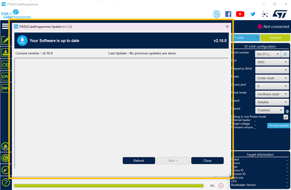

Step 1. Launch the STM32CubeProgrammer GUI (Graphical User Interface). In the bottom
left-hand corner of the screen, select the ‘?’ icon. Then select the ‘Software Update’ option.
Step 2. A STM32CubeProgrammer updater pop-up window will appear. Note that the contents of this window may differ, depending on the current version of STM32CubeProgrammer you are running. If you have any updates to make, please follow the pop-up window’s on-screen prompts.

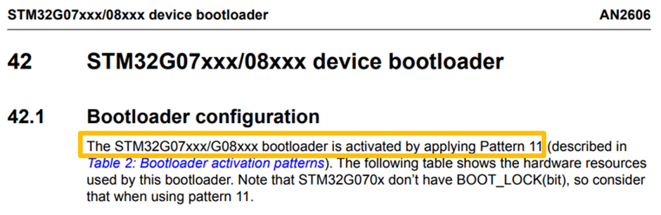

Locate your STM32 device in AN2606. This section will reveal the activation pattern you need to apply. In addition, provides the various available bootloader interfaces for your device, and even more importantly, the hardware resources required by the bootloader.
STM32G071’s Bootloader Activation Pattern Selection
In this example, we will select activation pattern 11, row 2. However, feel free in your application to select any of the available activation patterns listed.

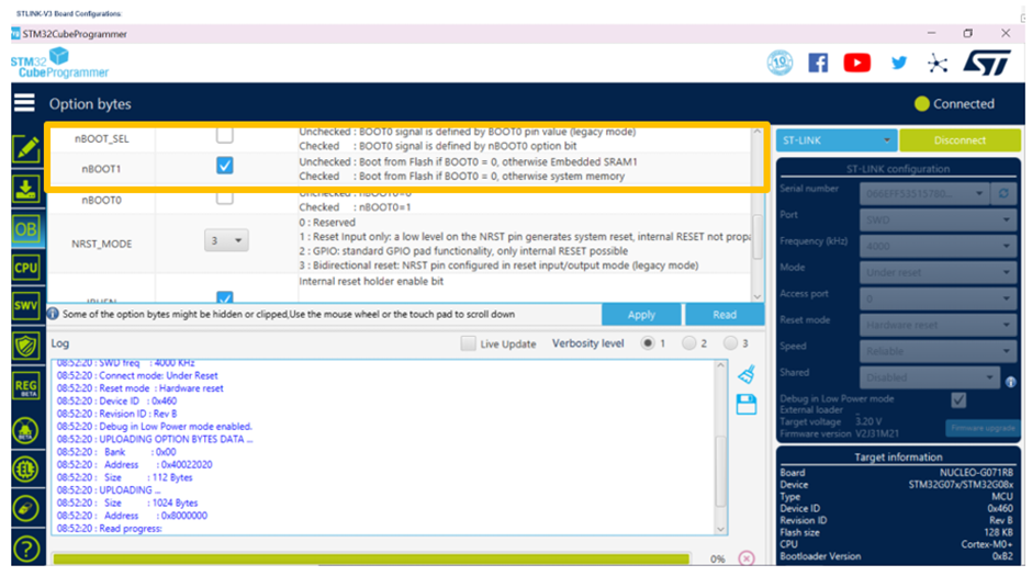

After connecting your target MCU board to STM32CubeProgrammer, on the left-hand side of the GUI select the “OB” tab and expand the “User Configuration” tab. Verify that Nucleo-G071RB’s option bytes bits nBoot1 = 1 and nBOOT0_SEL = 0.

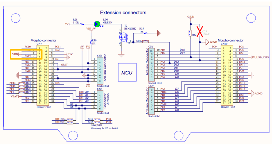

Once disconnected from STM32CubeProgrammer, connect PA14 (BOOT 0 pin) to VDD

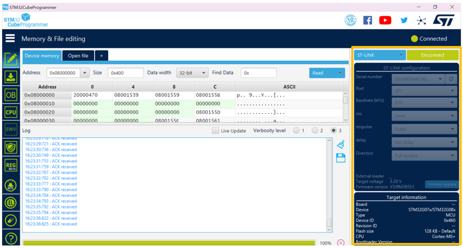

STM32CubeProgrammer Settings
- Serial Number: The ST-LINK V3SET’s
- This field contains the serial numbers of all connected STLINK-V3 probes in case of use of SPI bootloader
- Port: SPI
- Selects the SPI devices connected to the PC. Use the refresh button to recheck the available devices
- Baudrate: 375
- Selects the SPI baud rate
- Nss: Hard
- Slave select software or hardware
- Nsspulse: Pulse
- The slave selection signal can operate in a pulse mode, where the master generates pulses on nss output signal between data frames for a duration of one SPI clock period where there is a continuous transfer period
- Delay: No delay
- Used to insert a delay of several microseconds between data
- Direction: Full-Duplex
- Must be always full duplex, both data lines are used, and synchronous data flows in both directions
Congratulations! We have successfully used STM32CubeProgrammer and STLINK-V3SET to launch ST’s internal SPI bootloader on the Nucleo-G071RB board. The STM32CubeProgrammer GUI has various applications that can help you with your project. Some of the things you can do include but are not limited to reading from / writing to flash memory and RAM, reading / programming the device option bytes, and checking CPU register contents.
