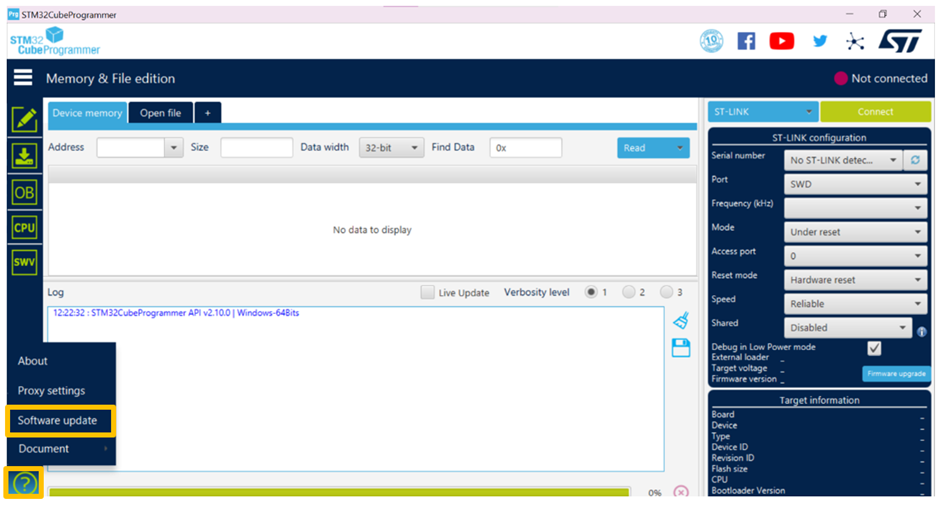

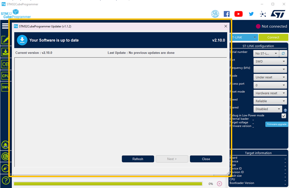

2. Step 1: Launch the STM32CubeProgrammer GUI (Graphical User Interface).
In the bottom left-hand corner of the screen, select the ‘?’ icon. Then select the ‘Software Update’ option.
3. Step 2: A STM32CubeProgrammer updater pop-up window will appear.
Note that the contents of this window may differ, depending on the current version of STM32CubeProgrammer you are running. If you have any updates to make, please follow the pop-up window’s on-screen prompts.

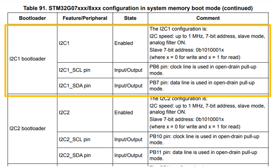

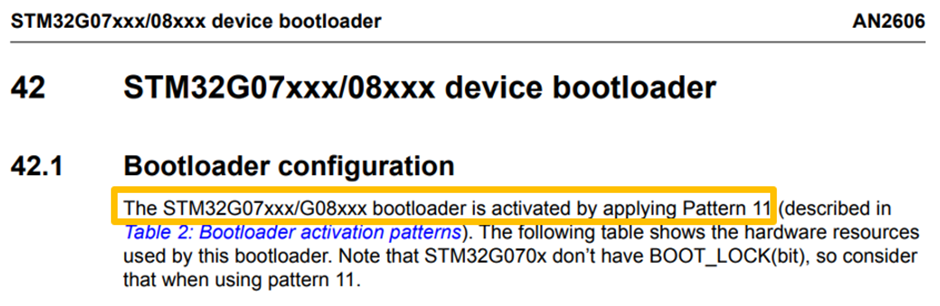

Locate your STM32 device in AN2606. This section will reveal the activation pattern you need to apply. In addition, provides the various available bootloader interfaces for your device, and even more importantly, the hardware resources required by the bootloader.

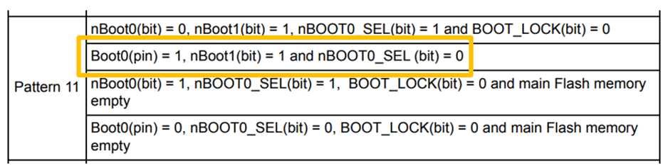

5. STM32G071 Bootloader Activation Pattern Selection
In this example, we will select activation pattern 11, row 2. However, feel free in your application to select any of the available activation patterns listed.

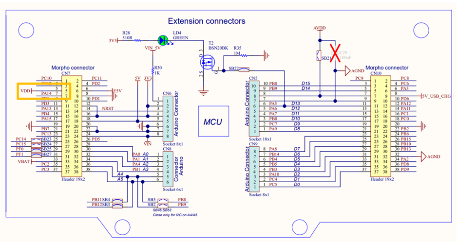

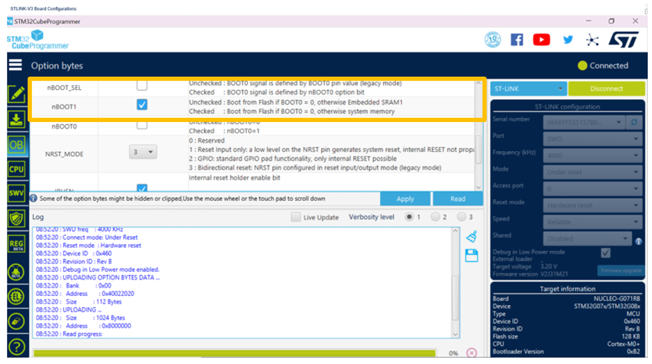

6. Nucleo-G071RB Modifications
After connecting your target MCU board to STM32CubeProgrammer, on the left-hand side of the GUI select the “OB” tab and expand the “User Configuration” tab. Verify that Nucleo-G071RB’s option bytes bits nBoot1 = 1 and nBOOT0_SEL = 0.
1047.pngOnce disconnected from STM32CubeProgrammer, connect PA14 (BOOT 0 pin) to VDD

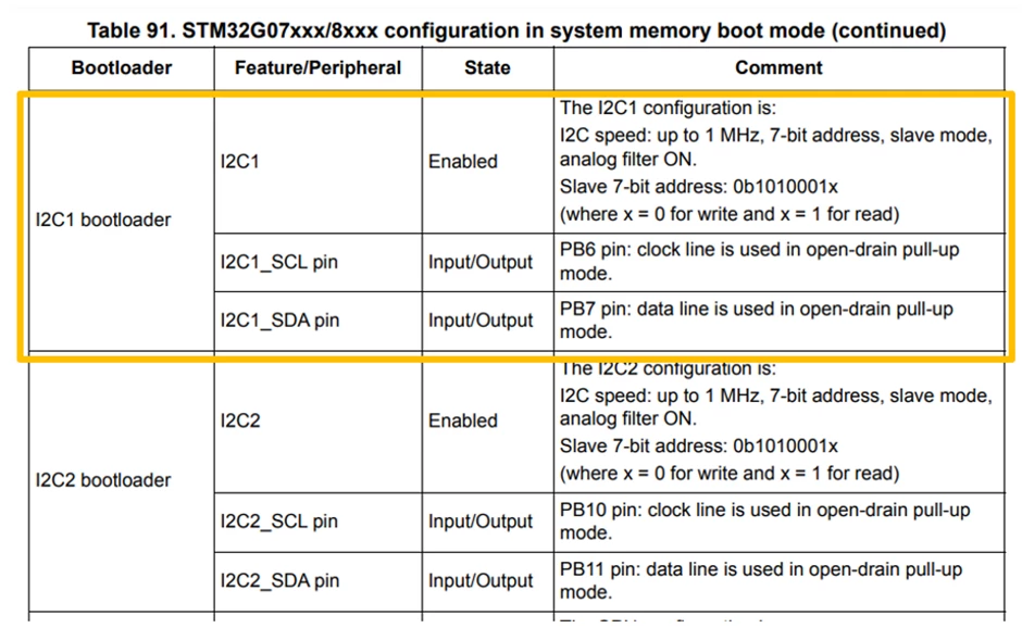

7. STM32G071’s I2C Entry Hardware Configurations
In this example, we will select I2C1 as our I2C bootloader entry point:

Nucleo-G071RB and STLINK-V3 Board Connections
Connection Established Nucleo-G071RB STLINK-V3 Set
GND JP5 CN6 – Pin 3
T_VCC (Target Voltage) CN7 – Pin 5 CN6 – Pin 1
I2C1_SCL (I2C Clock) CN10 – Pin 24, PB6 CN9 – Pin 7
I2C1_SDA (I2C Data) CN7 - Pin 21, PB7 CN9 – Pin 10
You will then need to power the Nucleo-G071RB board through the STLINK USB connector, and the STLINK-V3SET through CN5, the USB-Micro B connector.

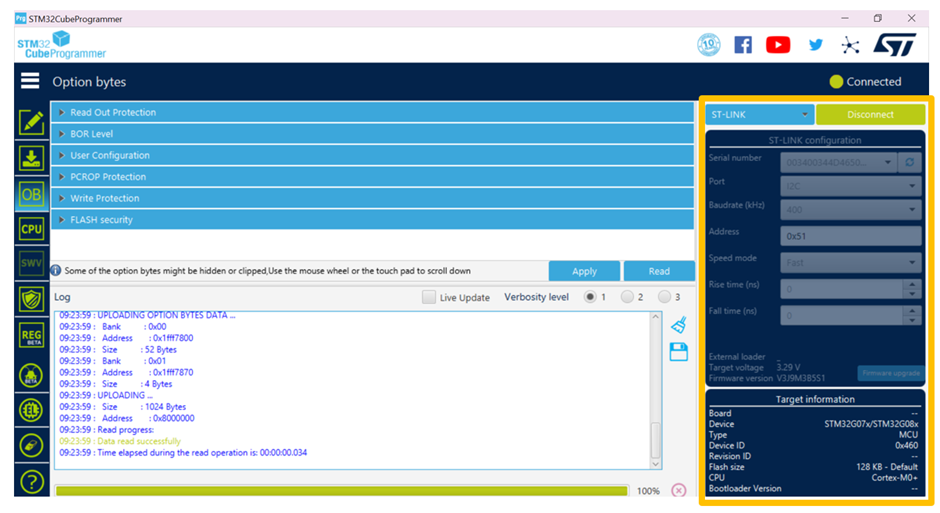

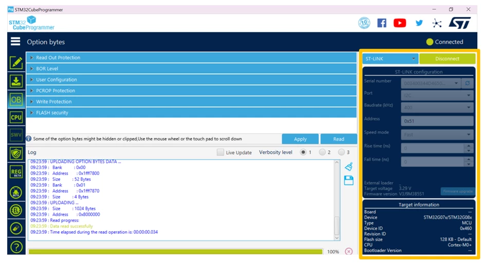

9. STM32CubeProgrammer Settings
  • Serial Number: The ST-LINK V3SET’s
    • This field contains the serial numbers of all connected STLINK-V3 probes in case to use I2C bootloader
  • Port: I2C
    • Selects the I2C devices connected to the PC – you can use the refresh button to recheck the available devices
  • Baudrate(kHz): 400
    • Selects the I2C baud rate
  • Address: Please note that the address given in AN2606 must be shifted to the right by 1 bit and put into STM32CubeProgrammer in hex: 0x51
    • Adds the address of the slave bootloader in hex format
  • Speed Mode: Fast
    • Selects the speed mode of the transmission – Standard or Fast
  • Rise Time (ns): 0
    • Chooses values according to speed mode, 0-1000 (standard), 0-300 (fast)
  • Fall Time (ns): 0
    • Chooses values according to speed mode, 0-300 (standard), 0-400 (fast)
Congratulations! We have successfully used STM32CubeProgrammer and STLINK-V3SET to launch ST’s internal I2C bootloader on the Nucleo-G071RB board. The STM32CubeProgrammer GUI has various applications that can help you with your project. Some of the things you can do include but are not limited to reading from / writing to flash memory and RAM, reading / programming the device option bytes, and checking CPU register contents.
