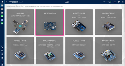

Then, choose the board you want to use with for your project. In this case, we use the B-U585I-IOT02A board and its available accelerometer.
Figure 2 - NanoEdge Board SelectionFigure 2 - NanoEdge Board Selection

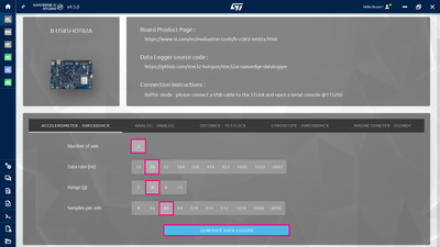

Once the board is selected, you need to configure the sensor and its parameters, including the number of axes, data rate, range, and samples per axis. In this demonstration project, the ISM330DHCX accelerometer is utilized. Choose the parameter values and proceed to click on [Generate Data Logger].
Figure 3 - Sensor SettingsFigure 3 - Sensor Settings

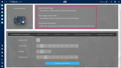

On this page, you can also view:
  1. Board product page: For more information regarding the selected board.
  2. Data logger source code: Available on our GitHub Hotspot Page, with the source code to create a custom data logger project. This is extremely valuable if you are planning to use this logger on your custom board. This code can be easily adapted to work on any STM32, as long as a serial port is available to stream data out.
  3. Simple connection instructions: Inform the baud rate for the VCOM.
 Figure 4 - Useful InformationFigure 4 - Useful Information

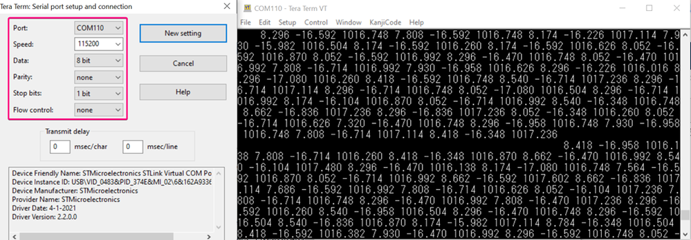

The onboard STLINK’s COM LED blinks while the binary is flashed onto the board. You can check the data logger in action by opening a VCOM Terminal and configuring it to your board’s serial communication settings.
For example, when using Tera Term, you can see the board’s sensor raw data being printed on the terminal:
Figure 6 - Raw Data DisplayFigure 6 - Raw Data Display
