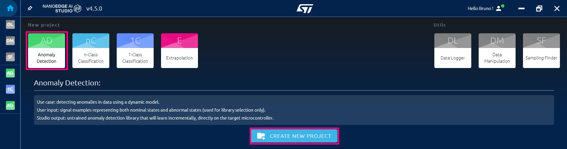

Now, back to the NanoEdge AI Studio Home Page, select the [Anomaly Detection] button to create a new project.
You will find a brief description of this project type, with its use case, user input, and studio output.
Click on [CREATE NEW PROJECT].
Figure 1 - New Anomaly Detection ProjectFigure 1 - New Anomaly Detection Project

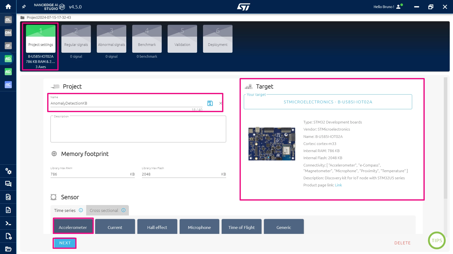

The project creation is divided in 7 simple steps. Note that not all of these steps are mandatory and this tutorial will skip the non-mandatory ones. This means that step 5: Validation and step 6: Emulator will not be shown in this tutorial and the article will jump from Step 4: Benchmark straight to Step 7: Deployment.
Step 1: Project settings. Here you can rename it, choose your board and sensor, and set a limit to flash and RAM usage if needed.
On this page, you also have some characteristics of the chosen board, with the description, available memory and sensors, and product page link.
Figure 2 - Project SettingsFigure 2 - Project Settings

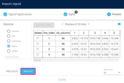

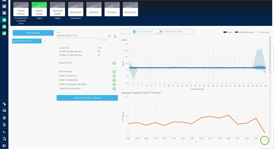

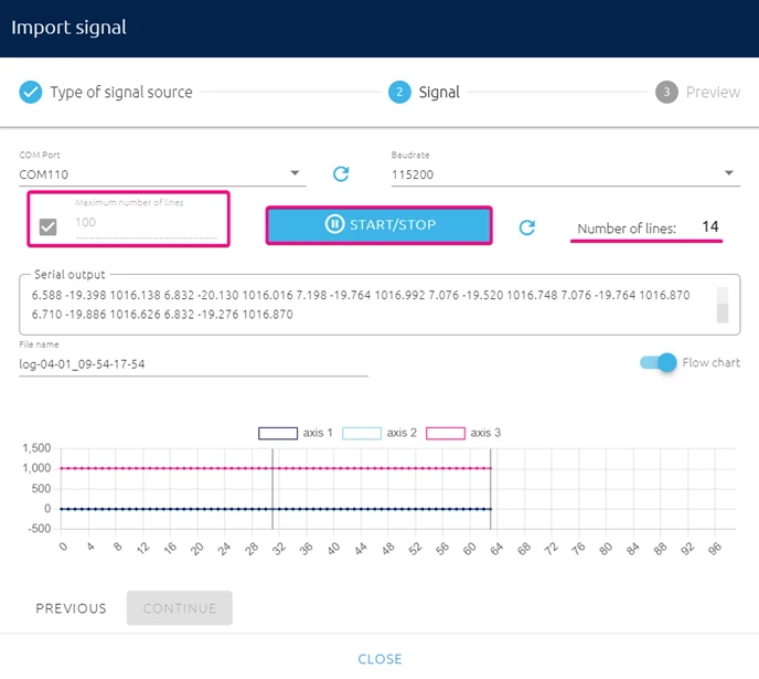

Step 2: Regular signals. In this step you need to add the signals to your project, which is your dataset. You can import your dataset or create it using NanoEdge AI Studio.
It is particularly important to follow the specified data format. The tool requires, for this project, n buffers of 256 values x 3 axes (x,y,z) with space separator. The "Best Practices” are also really helpful to make sure that you have the necessary data in your dataset. Since we create our own dataset, click on [ADD SIGNALS] and then on [FROM SERIAL (USB)].
For this step, remember to close the Tera Term terminal window to allow successfully collecting the data with NanoEdge AI Studio. Select the correct COM port and baud rate (115200), for this case, use 14 on the number of lines. Once that is configured, make sure that the board is positioned properly in the steady state and then click on the [START/STOP] button to start the acquisition. For this demonstration project, we will collect “Steady State” signals, which will be the data collected with the board steady horizontally only.
Figure 3 - Import SignalFigure 3 - Import Signal

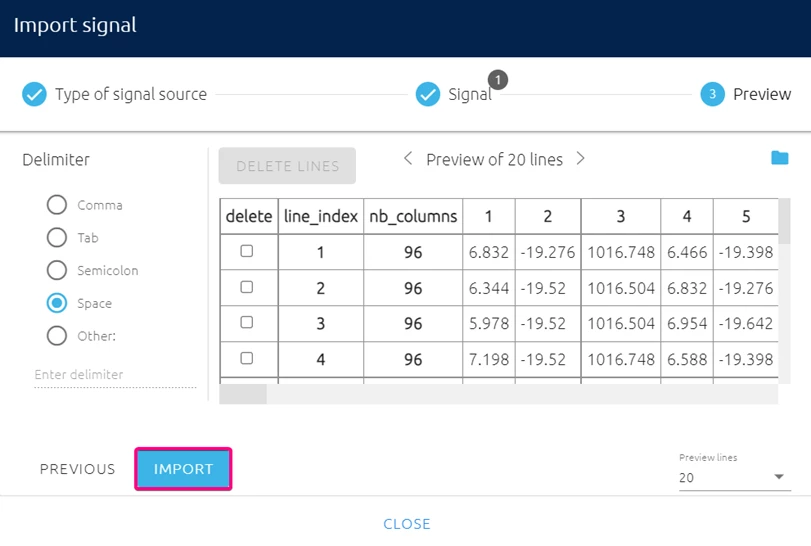

When it is all done, press the [CONTINUE] button and then [IMPORT] your dataset, with the default delimiter option.
Figure 4 - Import SignalFigure 4 - Import Signal
The NanoEdge AI Studio shows the collected signal file characteristics and generate graphics related to the input signal of each axis.
Figure 5 - Collected SignalsFigure 5 - Collected Signals

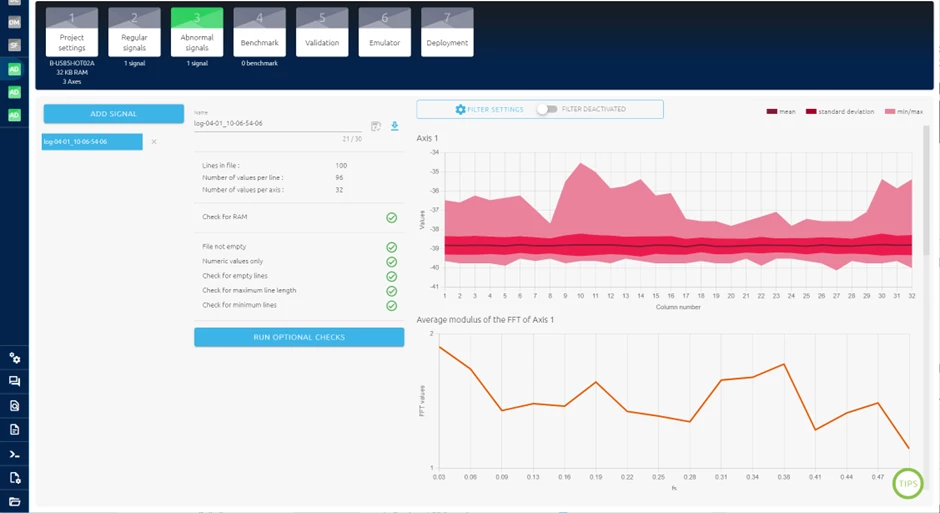

Step 3: Abnormal signals. This next step is very similar to Step 2, as we collect the abnormal signal of our application following the same steps as previously described. For this demonstration, we only turn the board upside down. This is our abnormal state.
You should have something similar to the following image:
Figure 6 - Abnormal SignalFigure 6 - Abnormal Signal

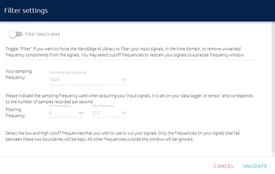

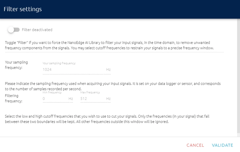

In this step, you can choose to enable the NanoEdge AI filters to remove unwanted frequency components from the signals as well.
Figure 7 - Filter SettingsFigure 7 - Filter Settings

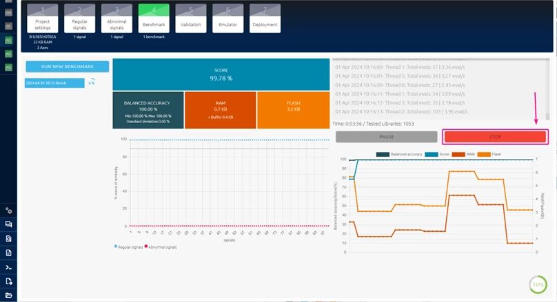

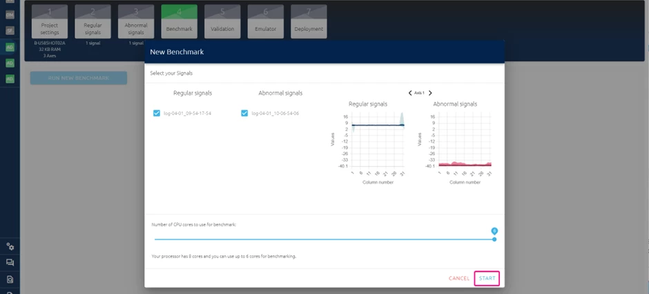

Step 4: Benchmark. Once the dataset is completed with the 2 inputs (regular and abnormal signal) we can start our benchmark. Go to Benchmark, click on [RUN NEW BENCHMARK], select the signal that is used and click [START].
Figure 8 - BenchmarkFigure 8 - Benchmark
The benchmark process begins, and here is where the NanoEdge AI Studio really shines! In this process, the tool will select the best machine learning algorithm for your application, based on the signal files shared.
You can see the score and balanced accuracy percentage, RAM, and flash usage. These parameters change in real time as new ML libraries are evaluated with your dataset.
The Benchmark can take several minutes to be completed, depending on your project complexity. For this example, a few minutes are more than enough. When the Score/Balanced accuracy percentage is already high enough for your application, as well as the RAM/flash low consumption, you can press the [STOP] button at the right side to stop and complete the process at any given time of the automatic process:
Figure 9 - Benchmark and ScoreFigure 9 - Benchmark and Score

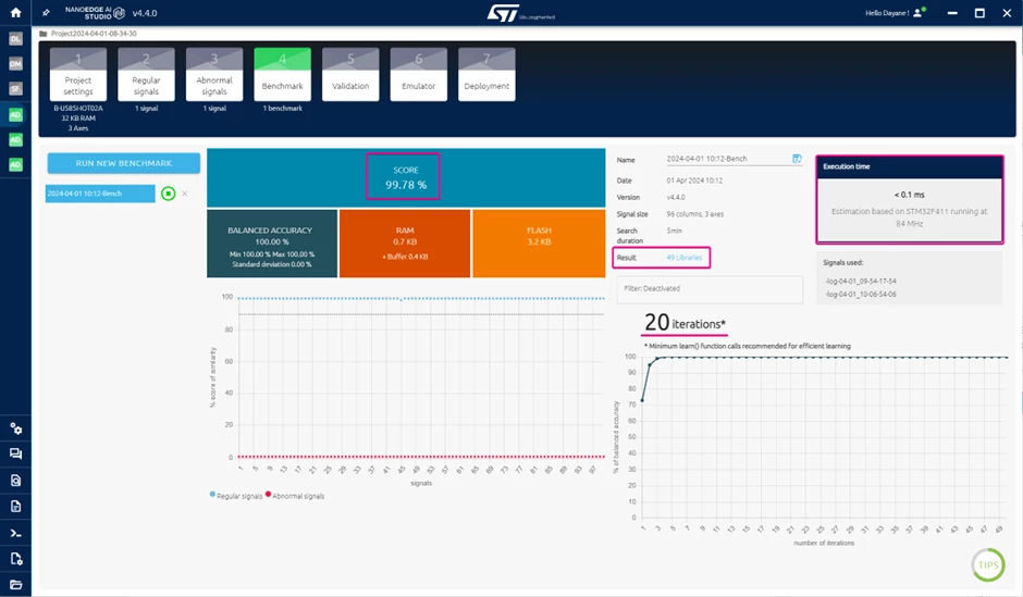

At the end, you will have more information, such as the benchmark score, execution time, search duration, and how many libraries were evaluated with your project at the “Result” area. Below this information, you will find the minimum recommended number of iterations (learn() function calls, which will be used later in the application.
Figure 10 - ResultsFigure 10 - Results

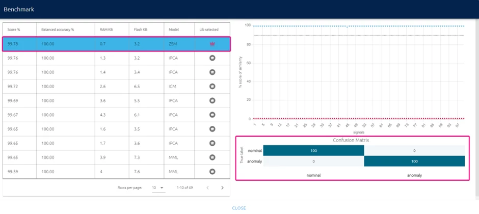

For this benchmark, 49 libraries were used to evaluate the performance of the project. You can see each library’s results and its confusion matrix.
The winner model was the ZSM and the basic information, including the confusion matrix, can be observed:
Figure 11 - Accuracy and Confusion MatrixFigure 11 - Accuracy and Confusion Matrix

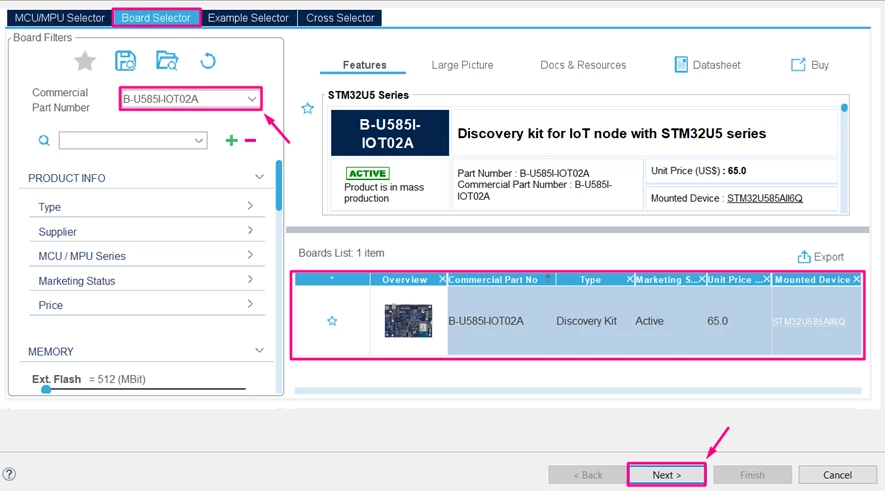

1.3. STM32CubeIDE project development
Now, let us work with the STM32CubeIDE to write our application code!
Firstly, you need to create a new STM32CubeIDE project for your board, we use B-U585I-IOT02A in this case:
Figure 12 - STM32CubeIDE New ProjectFigure 12 - STM32CubeIDE New Project

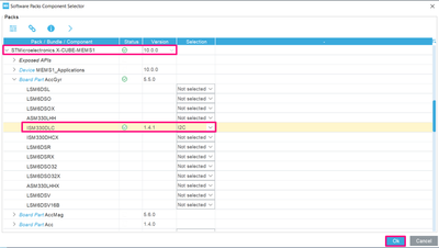

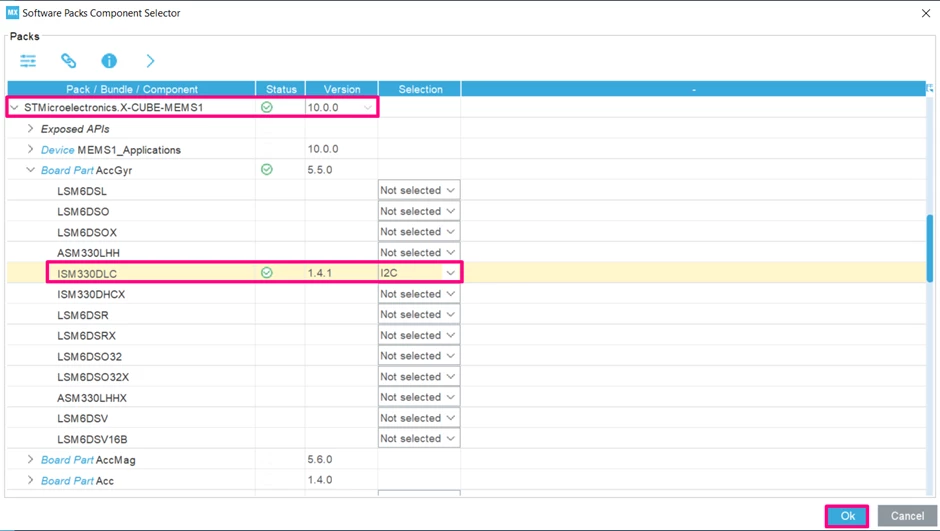

Once the graphic view loads, click in the [Software Packs] and [Select Components], locate the [X-CUBE-MEMS1] software package and add the [Board Part AccGyr] for the ISM330DLC, the one available in the board.
Figure 13 - X-CUBE-MEMS1 settingsFigure 13 - X-CUBE-MEMS1 settings
This holds the necessary files and codes for configuring the accelerometer. If you need more details on how to use it, consider watching this video tutorial: Getting Started with X-CUBE-MEMS1 (youtube.com)

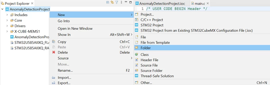

We need to add the *.h and *.a files to our project, so the first step is to create a folder within your project for the NanoEdge AI Studio Library:
Figure 15 - Create a New FolderFigure 15 - Create a New Folder

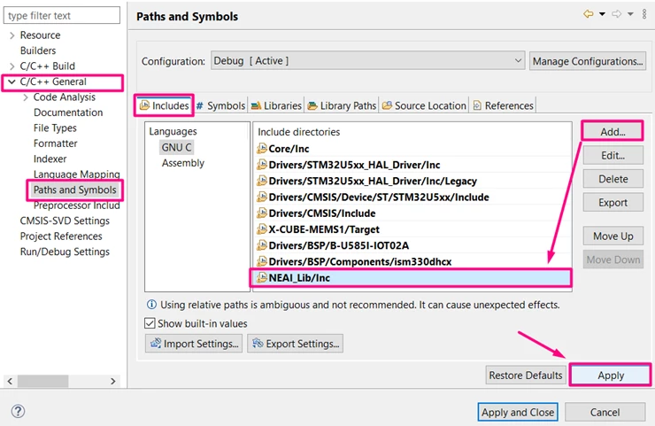

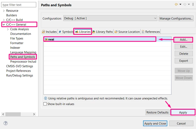

After adding the generated library to your project, right click on your project name and click on “Properties”. Then go to [C/C++ General] > [Paths and Symbols] > [Includes] and add the “NEAI_Lib/Inc” path then click on [Apply].
Figure 18 - Adding Library Part 1Figure 18 - Adding Library Part 1
Move to the [Libraries] tab and add “neai” library, then click on [Apply]:
Figure 19 - Adding Library Part 2Figure 19 - Adding Library Part 2

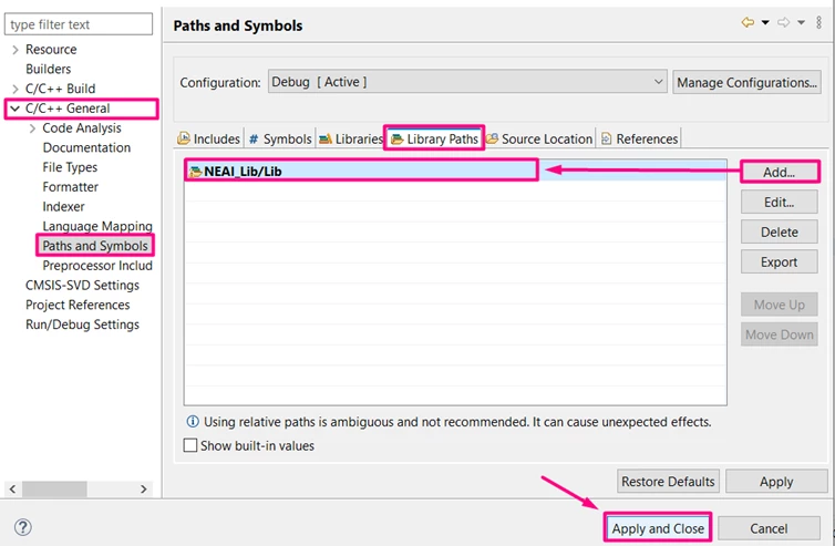

Finally, move to the [Library Paths] tab and add the “NEAI_Lib/Lib” library path, then click on “Apply and Close”:
Figure 2-- Adding Library Part 3Figure 2-- Adding Library Part 3

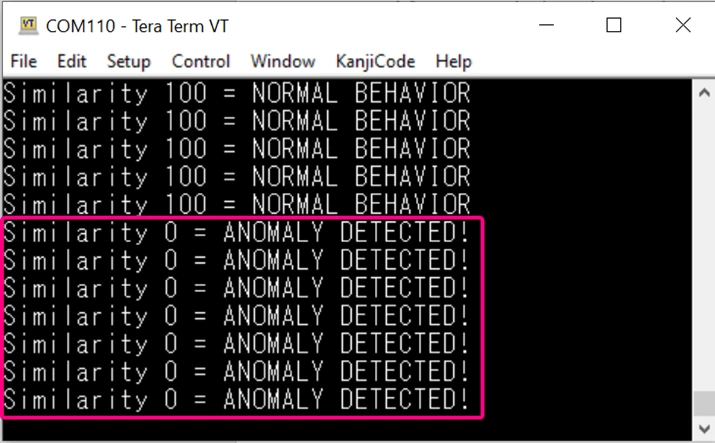

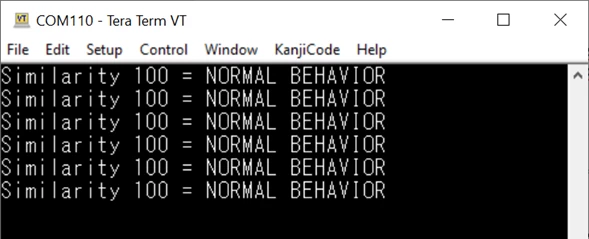

To verify if the code is properly working, open the Tera Term Terminal with the following parameters: 115200 / 8 / N / 1.
Leave your board horizontally steady. You can notice the correct behavior being printed:
Figure 21 - Normal BehaviorFigure 21 - Normal Behavior
Now, if you place your board upside down, or cause any disturbance, you can notice that the data collected is no longer recognized as “NORMAL BEHAVIOUR”.
Figure 22 - Anomaly DetectionFigure 22 - Anomaly Detection
