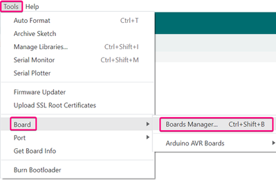

Now, click on Tools > Board > Boards Manager:
Select “Contributed” type, search for "STM32 MCU based boards" and install:

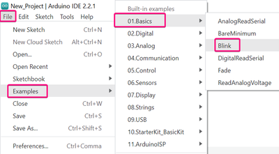

After installing the software and the STM32 cores, go to File > Examples > Basics > Blink:
The Blink LED code pops up in a new window and we can now set the appropriate STM32 board.

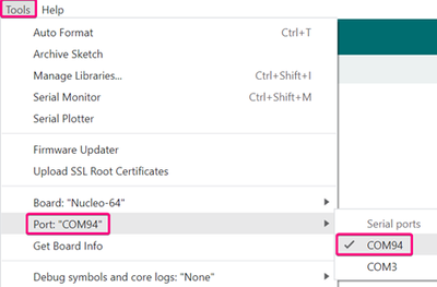

With the microcontroller correctly selected and the board properly connected, let us define the COM Port where the device is connected. Go to Tools > Ports > Select the Port Number:

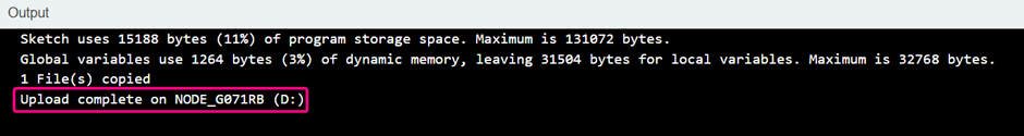

Click the Upload Button, wait for the code to be compiled and the board to be programmed:
As we can see, the download is successfully finished!
