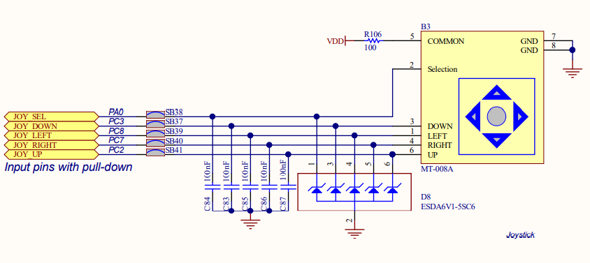

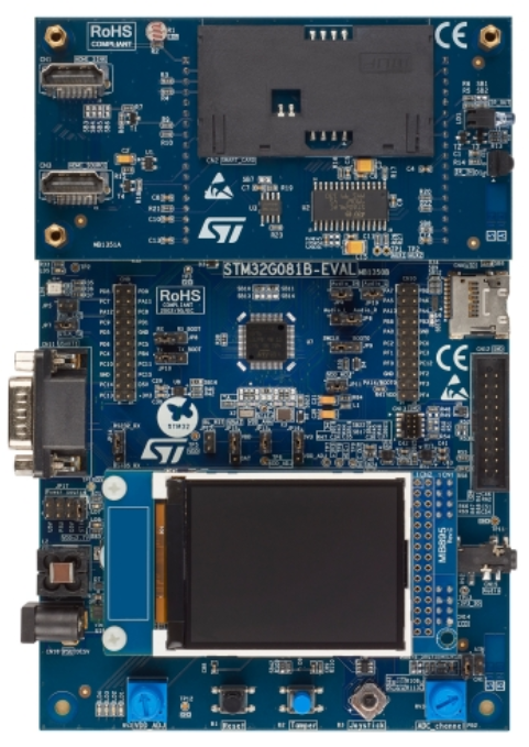

Let’s say we want to manage a joystick that has at least five output signals: Left, Right, Down, Up and select. We will manage it with five GPIOs on our STM32G0 configured as EXTIs. We will use the STM32G081-EVAL that has a joystick on it connected to five GPIOs of the STM32G081.
We will configure PA0, PC3, PC8, PC7 and PC2 as EXTI with pull-down and configure the polarity of the EXTI as rising edge. We will then see what code is needed to manage these five External Interrupts.

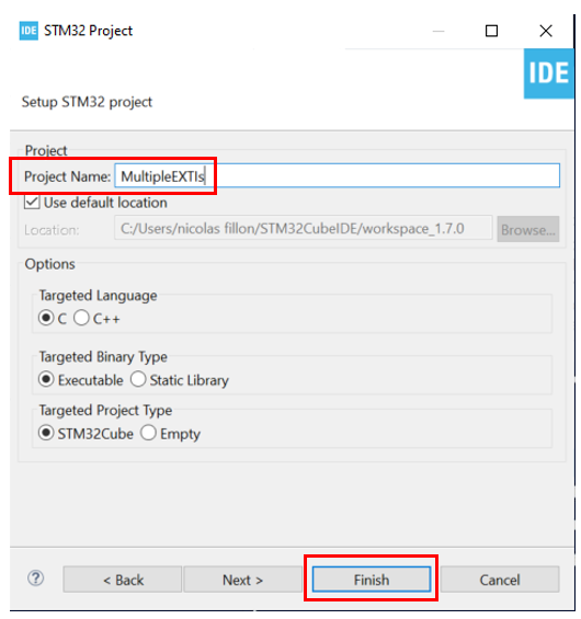

  1. Open STM32CubeIDE
  2. Create a new project for the STM32G081RBT6 that is on the board
  1. Give a name to the project

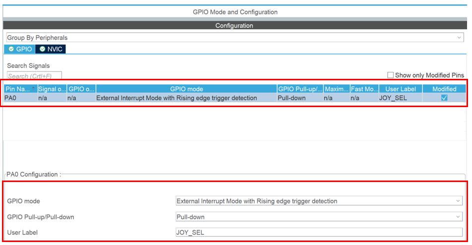

Let’s start with PA0. We will configure PA0 as an external Interrupt (EXTI) with internal pull-up.

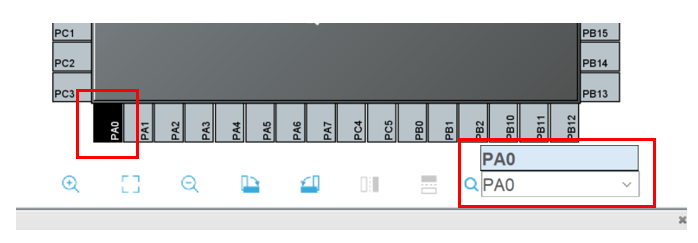

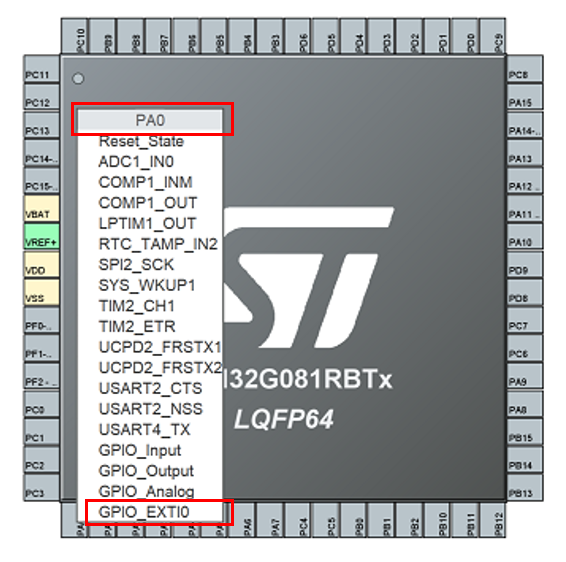

We will also add a user label “JOY_SEL”. To do this, from the pinout view we will search for PA0 in here:
Left click on PA0 and select GPIO_EXTI0

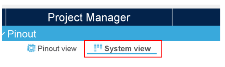

Now we will enable the internal pull-up and add the user label and change the polarity of the External interrupt edge to falling edge. To do this click on System View here:
Now click on GPIO
Add the following configuration:
  • Change the trigger detection to rising edge
  • Enable Internal Pull-down
  • Add user label

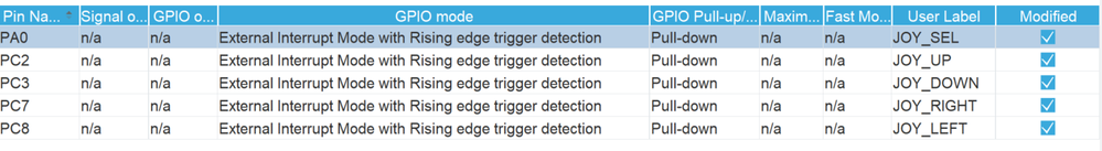

  1. Now repeat the same exercise for the rest of the GPIOs: PC3, PC8, PC7 and PC2
When finished, you should have the following configurations:

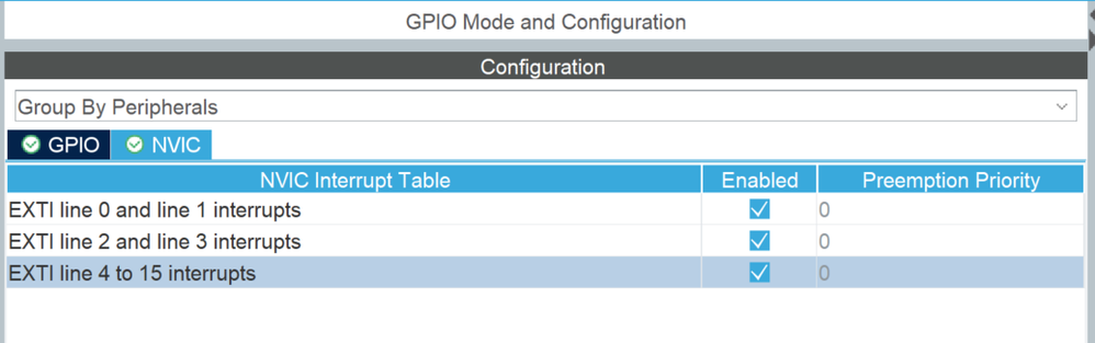

  1. Now enable the Interrupts for all EXTI lines used.
Go to the NVIC Tab of the GPIO and enable the three EXTI Interrupts:

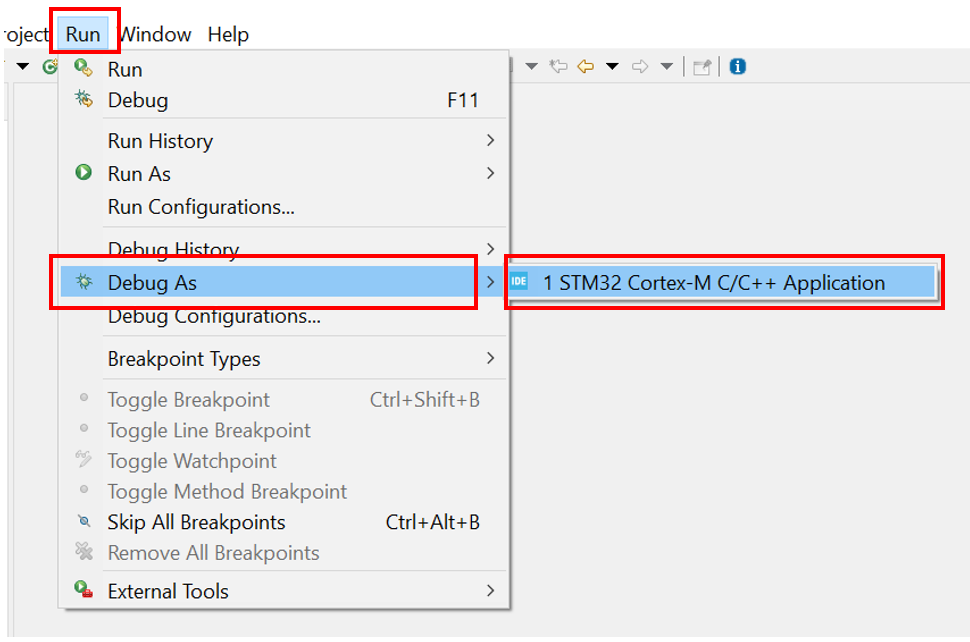

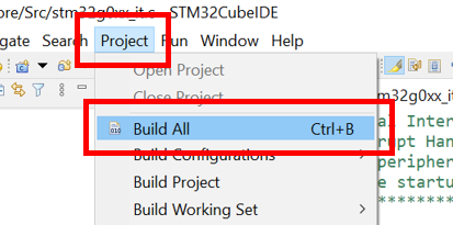

  1. Build the project, enter debug mode and run the code
After the project is built, enter a debug session.

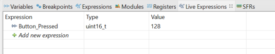

Add the variable Button_Pressed to the Live Watch Window.
Run the code:
You should now see the Button_Pressed being updated every time you press the different keys of the Joystick.
