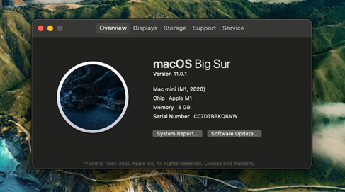

This article describes how to install STM32CubeIDE on a Mac with M1 core using Big Sur operating system and Rosetta 2.

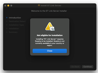

When installing STM32CubeIDE and included subprograms on Mac with M1 some of these dialogs may appear. If any of these dialogs appear Rosetta needs to be installed. If you know that Rosetta is not already installed, please install it by following the guide in next section.
The first dialog contains information about a problem to install ST-LINK Server. ST-LINK server is a program which is installed and needed when debugging a board using ST-LINK.
In this case use the command line documented in the next section to install Rosetta and relaunch ST-LINK Server installer.

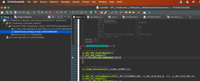

Seems able to install on M1. Running the app by double clicking results in:
With no option to override and launch anyway in Security settings. The CTRL+Click->Open method documented in the "?" also does not work. However, manually running the app from the terminal works:
/Applications/STM32CubeIDE.app/Contents/MacOS/STM32CubeIDE

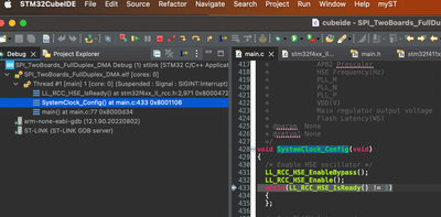

J-Link debug works.
ST-Link V2 also works.
