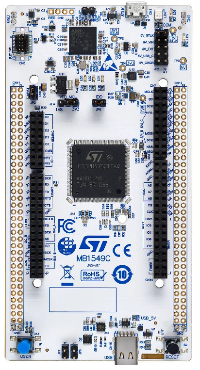

  • Nucleo MB1549-U5A5ZJT6Q1. Hardware and software setup

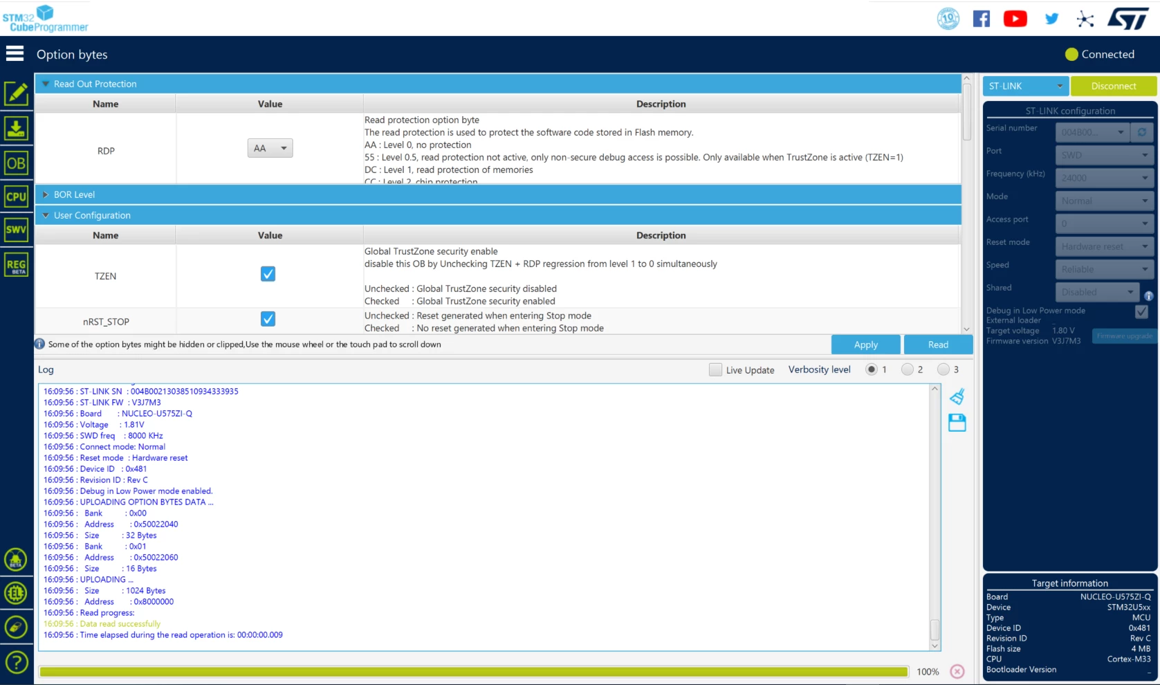

As you can see when connecting your board to STM32CubeProgrammer and checking the option bytes, TZEN is checked (TrustZone® enabled).

Step 1: Connect Boot0 to VDD on your board:
This consists on connecting PH3 pin (CN11 pin 7) to VDD (CN11 pin 5).

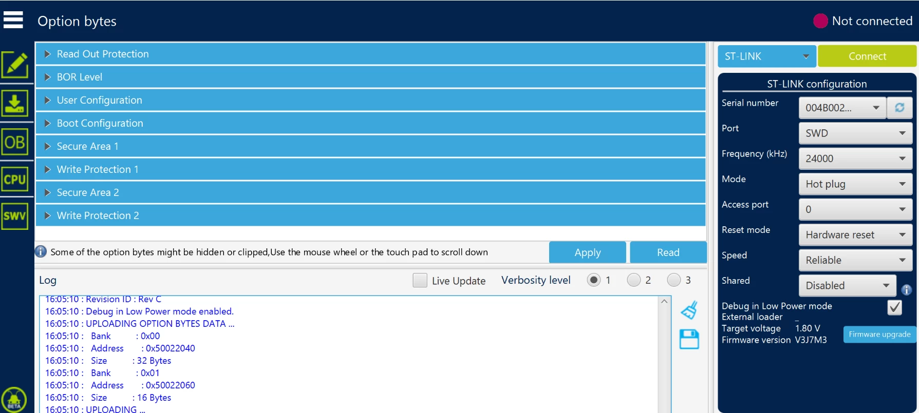

Step 2: Connect your board with STM32CubeProgrammer in "hot plug" Mode.

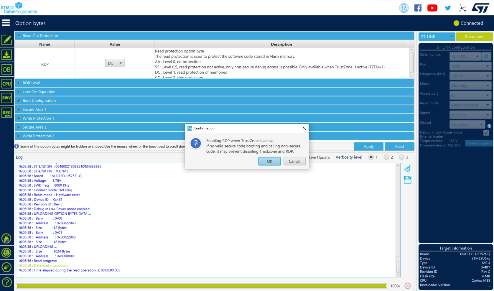

Step 3: Switch RDP value in “readout protection” to level 1, then click on apply.

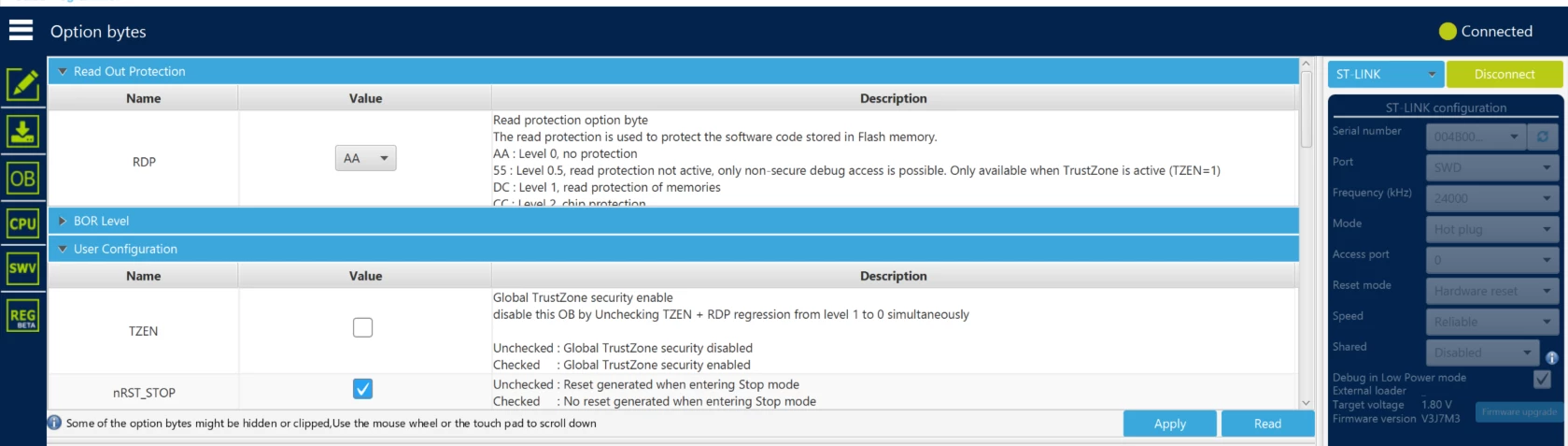

Step 4:
  • Switch RDP value to level 0

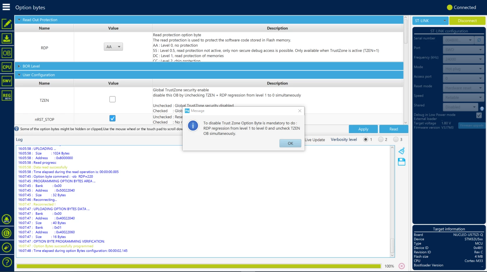

Step 5: Then click on apply to program the option bytes.
Step 6: Disconnect your board to STM32CubeProgrammer.
Step 7: Disconnect Boot0 to VDD.
Step 8: Connect again your board with STM32CubeProgrammer and make sure that TrustZone® is disabled(TZEN unchecked).
