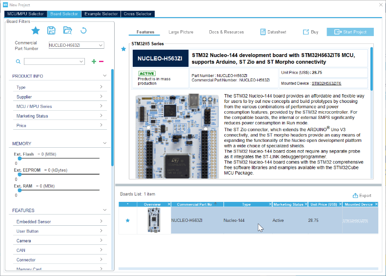

The first step is to open STM32CubeMX and search for one of the boards we mentioned in the prerequisites section. In our case, we use the STM32H563ZI.
You are prompted to decide whether to activate TrustZone.
Select [Without TrustZone activated] as we are not TrustZone for this example.

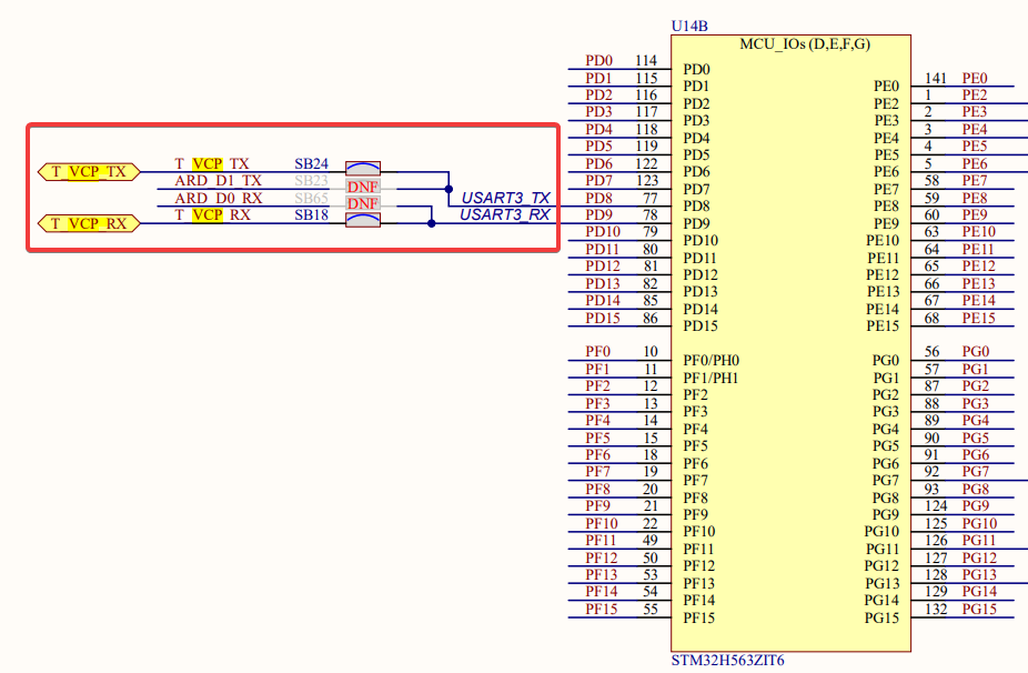

1.2 UART configuration
To simplify the debugging process, we use UART to print out debug messages to a serial terminal. To do this, we need to configure the appropriate UART that is connected to the on-board STLINK virtual COM port (VCP). By inspecting the STM32H563ZI board schematic and searching for VCP, we find that USART3 is connected to the VCP by default.
We enable USART3 in asynchronous mode and retain the default configuration. The only modification required is the pin assignment to ensure that UART is mapped to the virtual COM ports. This means we need to assign USART3_RX to PD9 and USART3_TX to PD8.

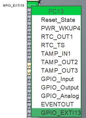

1.3 GPIO configuration
Next, we configure the GPIO for the user button to act as an external interrupt, initiating data transmission/reception upon activation. According to UM3115, the user button is mapped to PC13. Configure this in STM32CubeMX as follows:

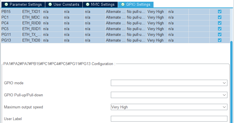

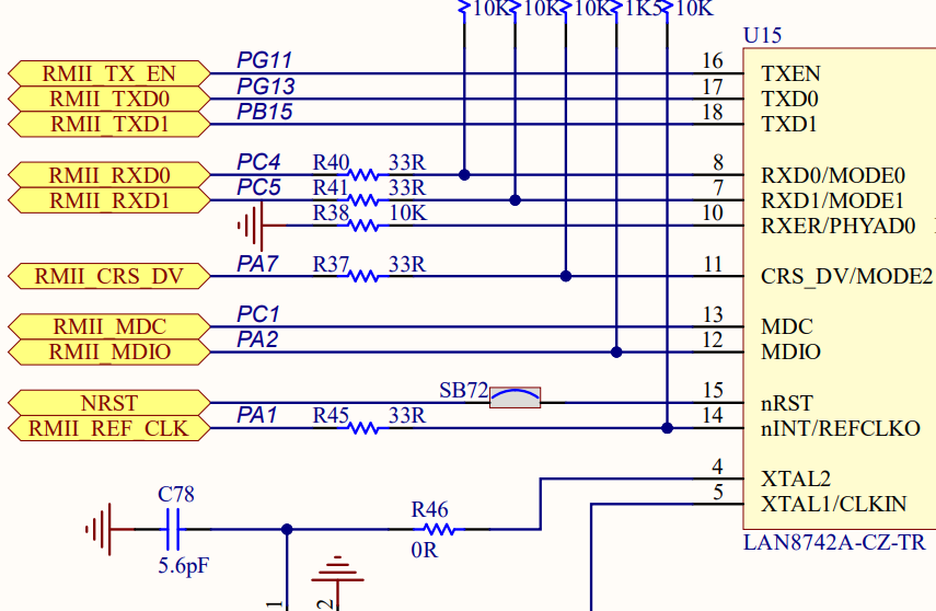

1.4 Ethernet peripheral configuration
For Ethernet configuration, begin by enabling the peripheral in RMII mode, which is supported by our board and uses fewer pins (7 pins) compared to MII mode (16 pins). As with the USART3 configuration, ensure that the pins are correctly mapped to the MCU. Adhere to the pin configuration as detailed in the board schematic:
Next, increase the GPIO pins' maximum output speed to [Very High] in the GPIO Settings. To do this quickly, select the first pin, hold Shift, and then select the last pin to highlight all pins in between. Now, scroll down and set the maximum output speed to [Very High] as shown below:

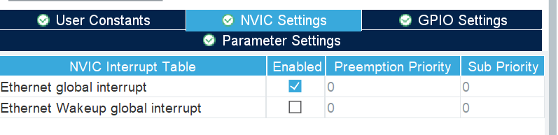

Finally, since we are using Ethernet in interrupt mode for this example, we need to enable the Ethernet global interrupt in the NVIC Settings.

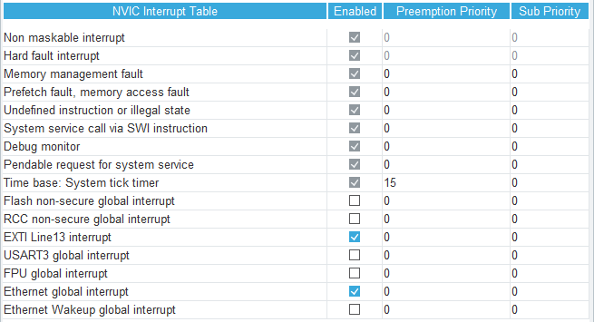

1.5 NVIC configuration
As previously mentioned, this example operates in interrupt mode, so we must configure the NVIC by enabling the EXTI Line 13 interrupt, which corresponds to the user button.

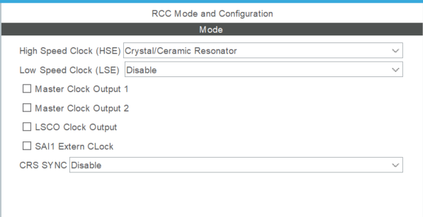

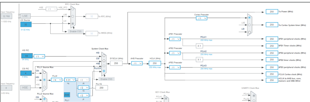

1.6 Clock configuration
For clock configuration, start by adjusting the RCC mode to select Crystal/Ceramic Resonator as the High Speed Clock. In the Clock Configuration tab, use HSI as the PLL1 Source Mux. Use PLLCLK as the System Clock Mux to achieve a frequency of 250MHz, as illustrated in the clock tree.

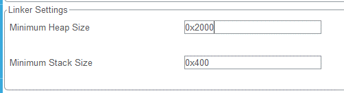

1.7 Linker Settings

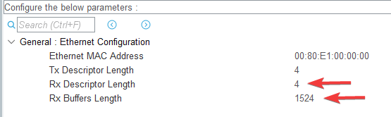

Ethernet frames can be up to 1524 bytes in size, or up to 9000 bytes with jumbo frames enabled. Therefore, it is essential to increase the heap size to accommodate 4 Rx Buffers. The significance of this configuration is explained later in the guide.
You may ask yourself, why 4 Rx Buffers? In the Ethernet Configuration tab of STM32CubeMX, we find the following:
To calculate the necessary heap space, multiply the Rx Buffer Length by the Number of Rx Descriptors, as each buffer is associated with a descriptor:
Required Heap Space = 1524 bytes per buffer * 4 buffers = 6096 bytes
This equals 0x17D0 in hexadecimal. We round it up to 0x2000 to allow for any additional requirements.
Note: In our case, we test with simple messages so we use small buffers.
All that remains is to choose a name for the project and click [Generate Code]. You will receive a warning about not enabling ICACHE. Select [Yes] to proceed with code generation.

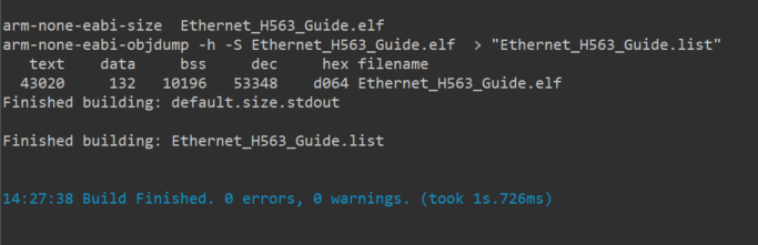

If all goes well, you should get no errors or warnings when you build the project.

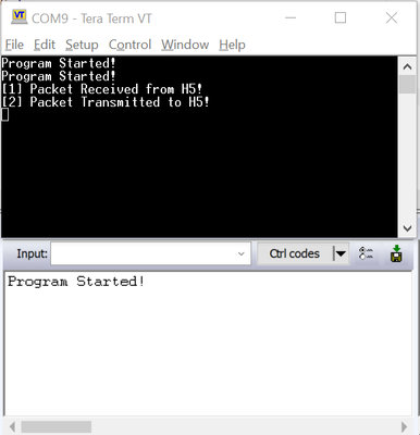

3. Testing the application
To test our application, we construct a ping pong communication between an STM32H723 board and STM32H563 board. When one of the boards transmits a frame, the other board receives the data and sends a response. This process repeats itself until interrupted by the user.

Moving on, we utilize the user button configured in CubeMX to transmit a frame upon detecting a rising edge external interrupt. Therefore, we must define the HAL_GPIO_EXTI_Callback() function in the user section to be executed when the button is pressed.
void HAL_GPIO_EXTI_Callback(uint16_t GPIO_Pin)
 if (GPIO_Pin == GPIO_PIN_13) {
 HAL_ETH_Transmit_IT( & heth, & TxConfig);
 HAL_ETH_ReleaseTxPacket( & heth);
 HAL_ETH_ReadData( & heth, (void ** ) & frame_Rx);
 } else {
 __NOP();

4.3 Demonstration
Finally, all that is left to do is to build the project and test it. To do that, we need to open a terminal emulator and connect to the serial COM port at the correct speed. After running our project and initializing all the necessary peripherals, we can attempt to send an Ethernet frame to the board. If successful, this triggers the callback function, which starts the ping pong communication between the two boards.
PS:  This example does not handle memory management of received packets. It serves only as a mean to explain the programming process of ethernet to ease the setup when using middlewares
