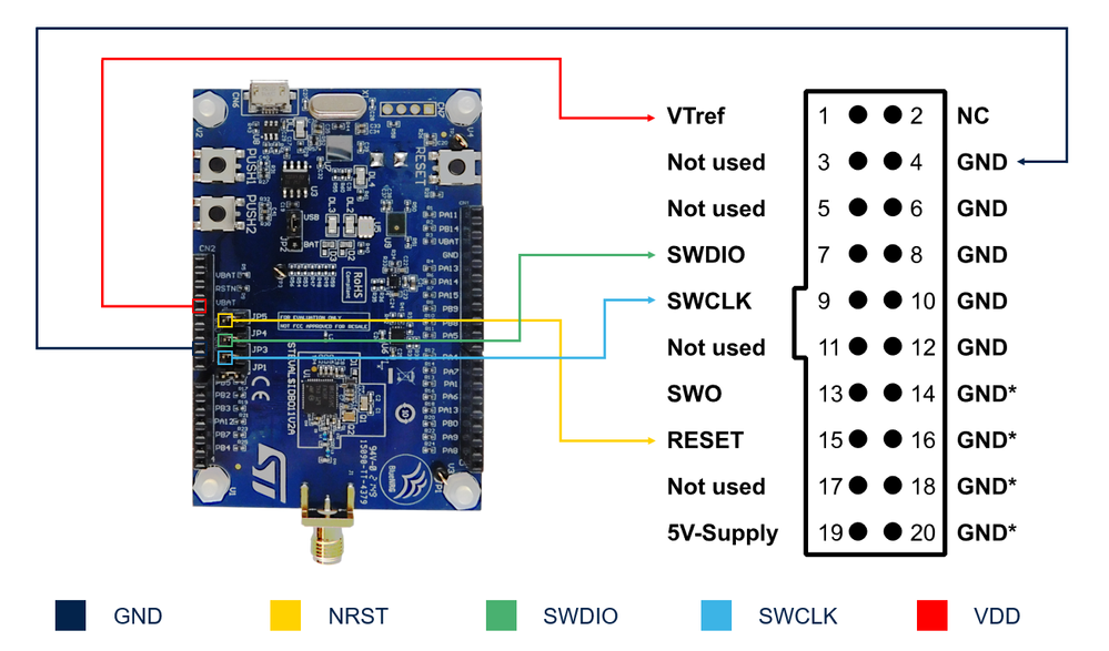

On the STEVAL-IDB011V1/V2 board, the JP3, JP4, and JP5 jumpers should be removed to disconnect the CMSIS-DAP SWCLK, SWDIO, and RSTN pins from the respective BlueNRG-LP pins.
STEVAL-IDB011V2 Jumpers Removal
2. STEVAL-IDB011V1/V2 and J-Link Debug Probe Pin Connections
On the STEVAL-IDB011V1/V2 board, connect the BlueNRG-LP SWD pins (left-hand side of JP3, JP4, & JP5) and CN2 GND & VBAT pins to the following pins on the J-Link debug probe.
| Signal | STEVAL-IDB011V1/V2 | J-Link debug probe |
| SWCLK | Pin 1 - JP3 | Pin 9 - SWCLK / TCK |
| GND | Pin 7 - CN2 (GND) | Pin 4 - GND |
| SWDIO | Pin 1 - JP4 | Pin 7 - SWDIO / TMS |
| NRST | Pin 1 - JP5 | Pin 15 - NRST |
| VDD | Pin 4 - CN2 (VBAT) | Pin 1 - VTREF |
STEVAL-IDB011V2 J-Link Connection
Now, power the J-Link debug probe and power the STEVAL-IDB011V1/V2 via the Micro-USB port.
Launch your J-Link software and connect. Congratulations! You have successfully established a connection between the BlueNRG-LP on the EVAL board and the Segger J-Link debug probe.
