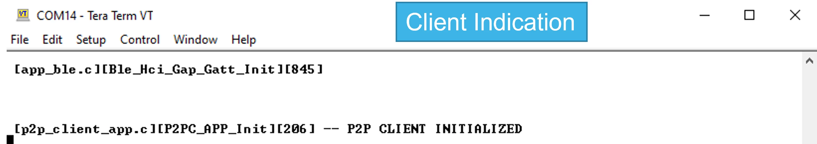

The initial connection process will be described as specified within the BLE standard.  The implementation is reflected in the example presented for both the client and server application as described within this document.  The example will be implemented on two Nucleo boards in order that the process may be repeated.  It has been experienced that different smart phones do not respond or react in identical ways, thus, the implementation is based upon the Nucleo boards.

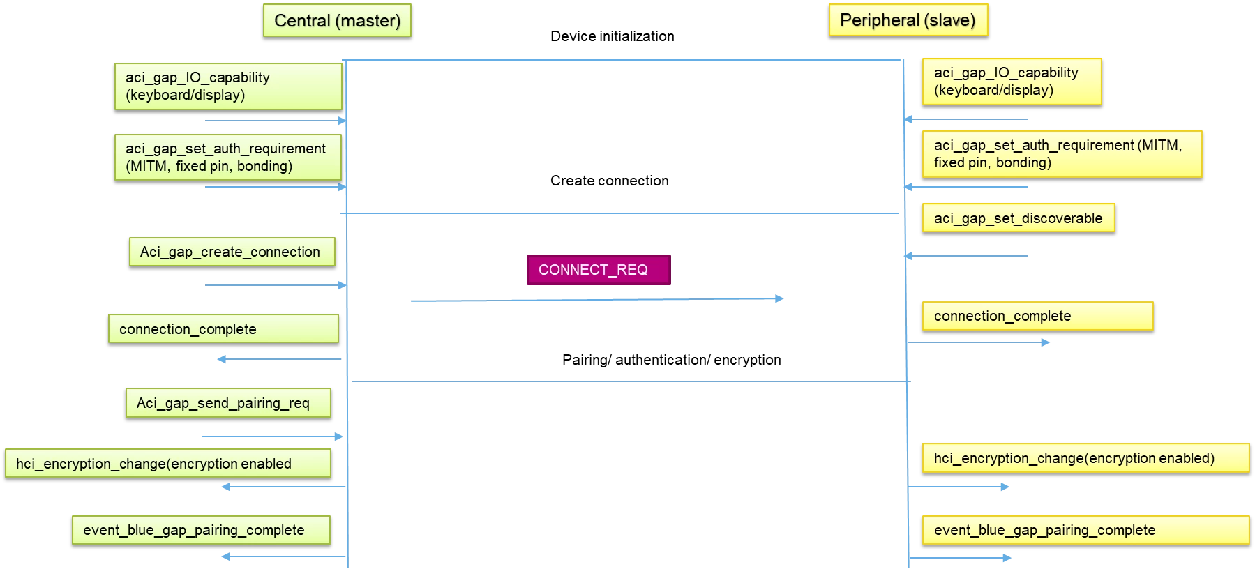

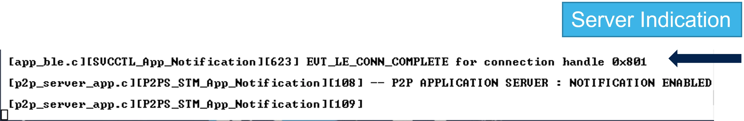

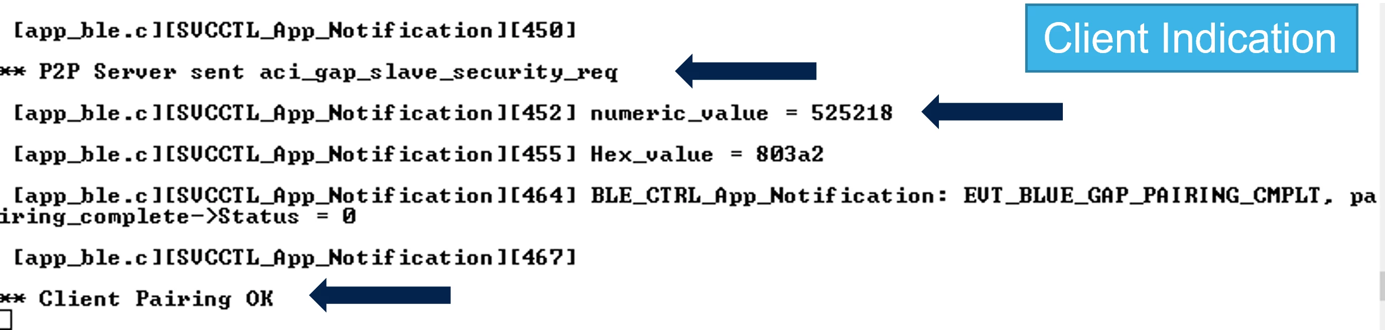

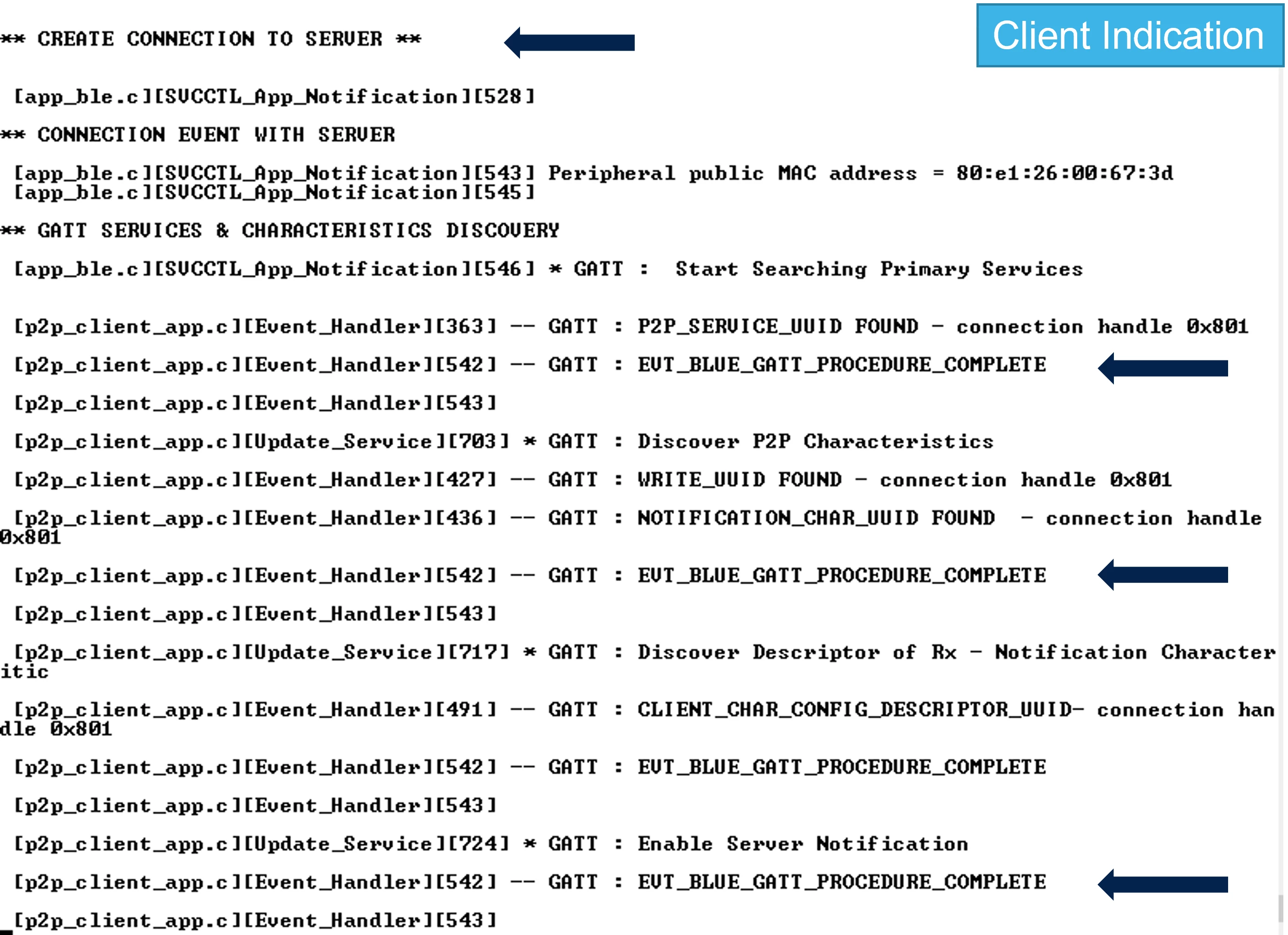

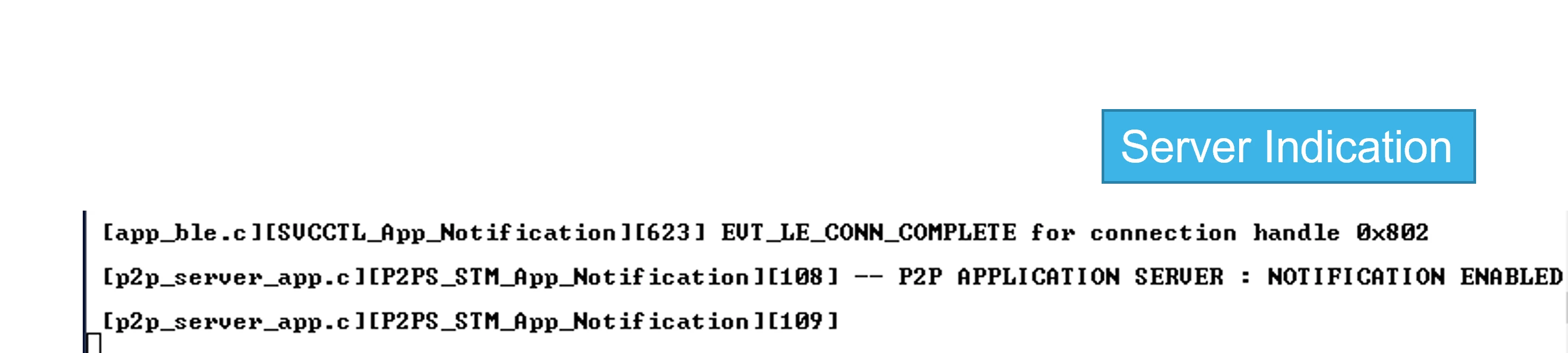

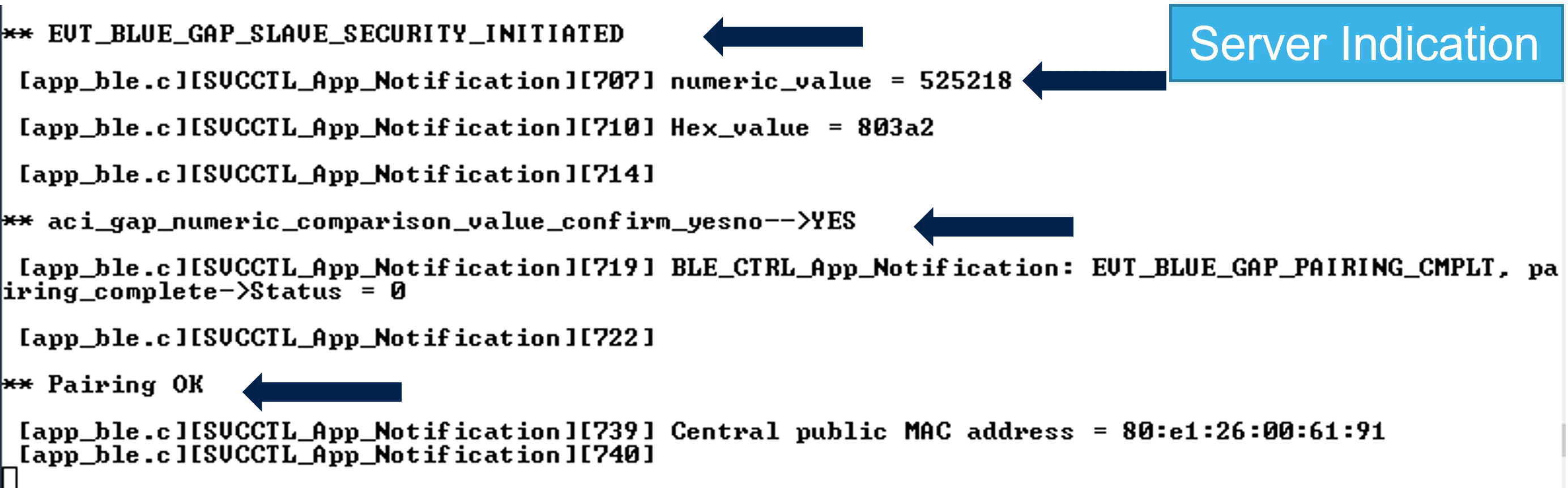

Figure 1 summarizes pass one of the process and also the structure of the project to be presented.  The server begins in advertising mode, the client is scanning.  The IO capability is established.  In this case a yes/no numeric comparison is used as the input mechanism.  The bonding configuration is set and scanning and advertising events are enabled.  The connection process begins and ends with an event blue gap pairing complete on both the central and peripheral.  The two devices are now connected, bonded and whitelist established.  The whitelist process allow for session encryption and session address information to be stored and retrieved quickly for a directed re-connection when requested.
Figure 1: Connection Process

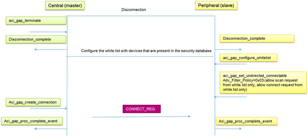

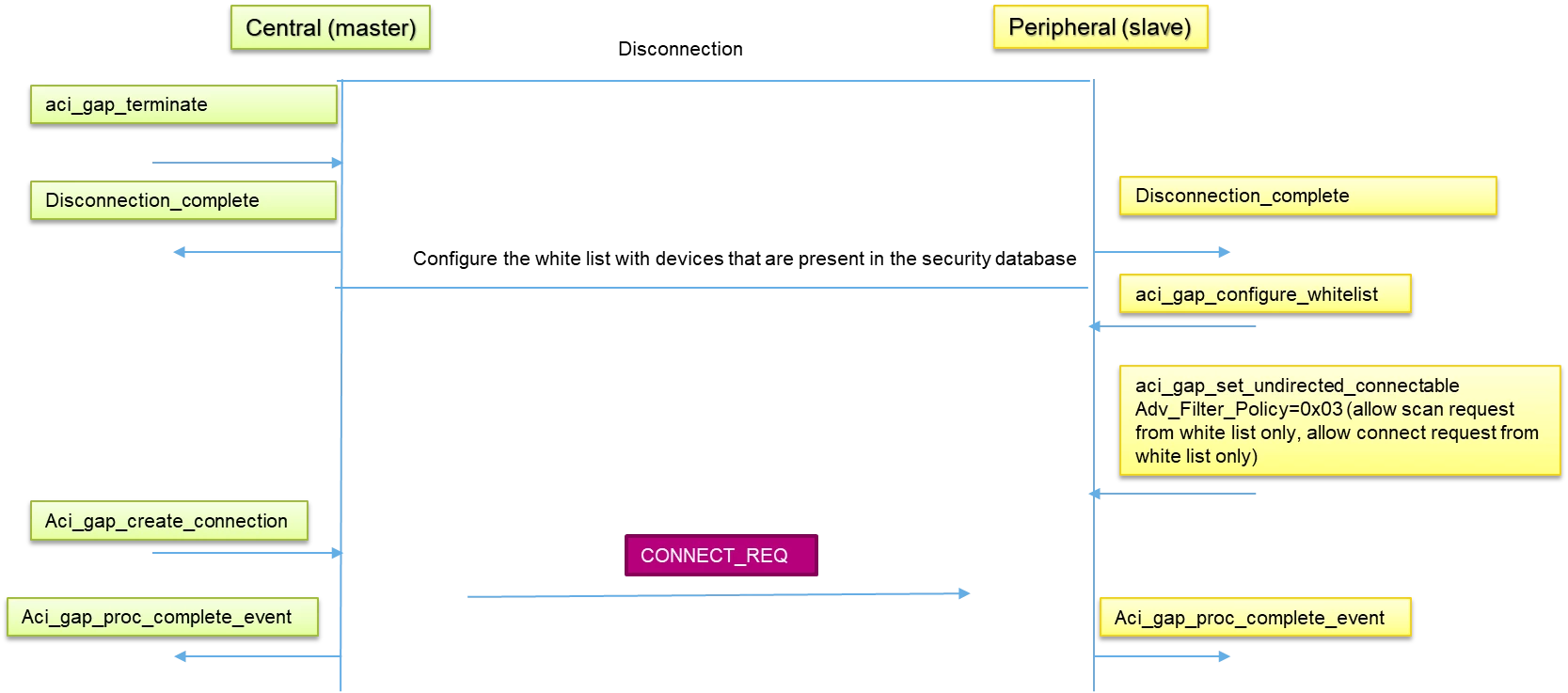

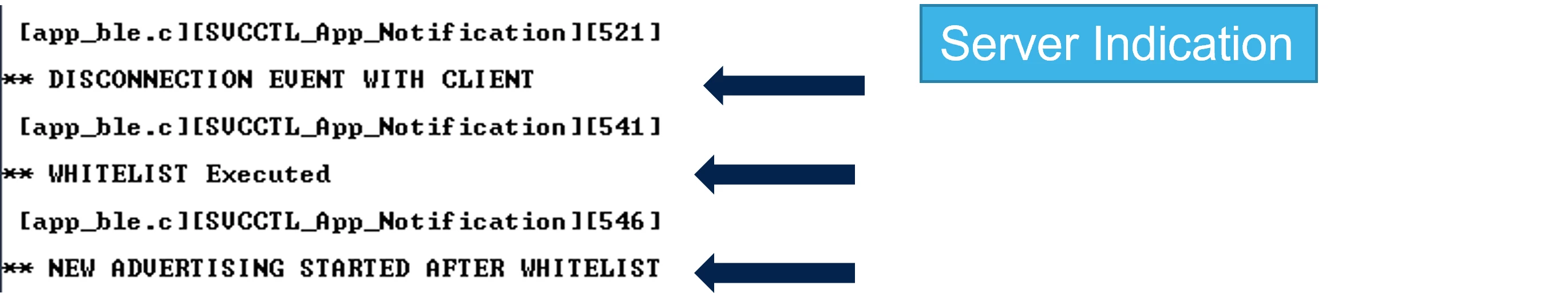

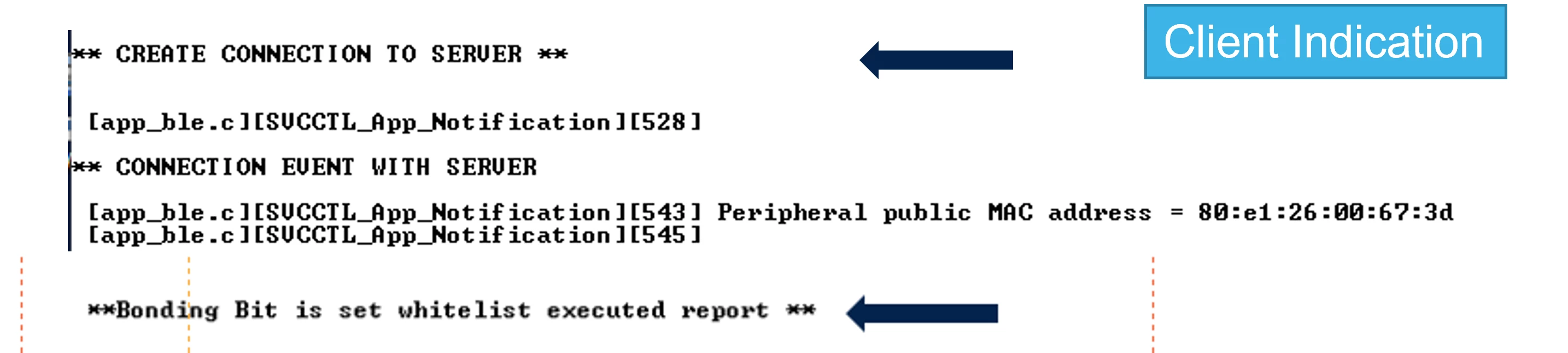

Once connection is established, the client initiates a disconnect command using aci_gap_terminate().  Figure 2 summarizes the process after disconnection.  The server sends a aci_gap_configure_whitelist() command to store and associate the whitelist entry with the bonding information.  It then begins a new advertising procedure.  However, this time, the advertising is with aci_gap_set_undirected_connectable(),  with filter policy 3.  This represents the whitelist advertising and with this setting, the advertising AD flag not set.  This ensures that the advertising server will not be visible or connectable to non whitelist clients.
In parallel, the client begins a general scan with its scanning filter policy enabled to connect to only whitelist entries.  Once a connection event is detected, it will check that the event handler for a SCAN_RSP.  Within the scan response data, the server’s public address must be present to qualify whitelist device.  The process of qualifying the server’s correct public address is important to prevent connection with another device.  At this time, it can connect to the intended server or peripheral.
Figure 2: Whitelist Reconnection Process
