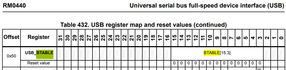

  • USB_BTABLE register: Specific to version 1 and not present in version 2:

The location and size of each buffer are specified in a buffer description table. Each table entry corresponds to an endpoint register of 16-bit. The start address of the buffer description table must be aligned to an 8-byte boundary.
  • 2 bytes for Tx buffer address
  • 2 bytes for Tx byte count
  • 2 bytes for Rx buffer address
  • 2 bytes for Rx byte count

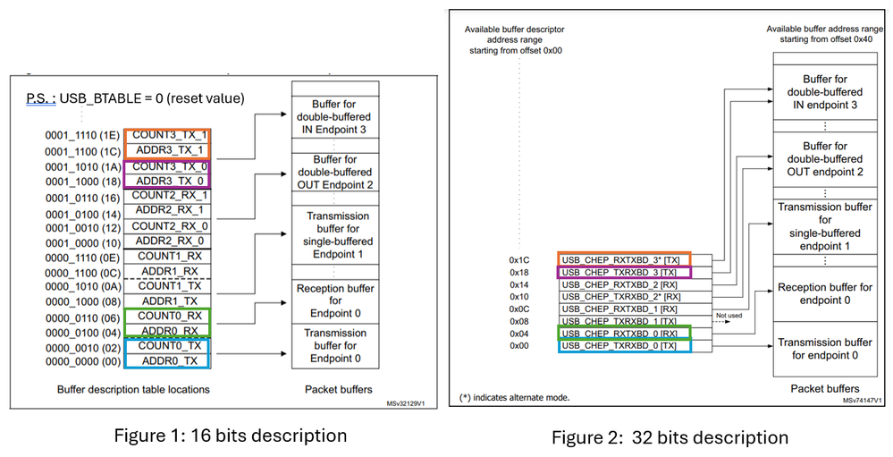

The following figures illustrate packet buffer areas with examples of buffer description table locations for two versions of USB controllers with minor changes.
Figure 1 is extracted from Figure 674 in RM0440 and Figure 2 from Figure 790 in RM0481.
  • The diagram shows buffer descriptor registers (CHEP_TXRXBD_n) for endpoints 0 to 3, while support for buffer descriptors can be extended up to endpoint 7.
  • The buffer descriptor table starts at offset 0x00.
  • The packet buffers (actual data buffers) start from offset 0x40 in PMA.
  • The available buffer address range could be optimized starting from offset inferior to 0x40.
    0x40 is the worst case allocation.

gbm
October 22, 2025
1. A simple but important piece of information is missing from the article: Which microcontrollers have PMA_ACCESS=1 option and which ones PMA_ACCESS=2? The information may be (not always easily) found in RefMan but it clearly is missing from this text.
2. I am too dumb to understand this; compare these 2 paragraphs from the above article:
"For 2 x 16 bits/word access scheme devices (PMA_ACCESS=1) we recommend that buffer addresses are aligned to 1 byte (8 bit) boundaries for optimal performance. Or half-word (16-bit) accesses. Word (32-bit) access is not allowed."
"For USB controller V1, buffer addresses should be half-word (2 byte) aligned. In some cases (2 x 16 bits/word access scheme), 1-byte alignment may be optimal. Refer to the specific controller documentation."
So, the PMA addresses should be aligned to 2 but alignment to 1 may be needed for "optimal performance". Huh?!
Any location aligned to boundary of 2 or 4 is also aligned to a boundary of 1. So, alignment to 2 or 4 is also "alignment to 1 byte". This has nothing to do with the fact that no 32-bit access is allowed. The buffer address may still be aligned to 4. I believe that for OUT EPs, the buffer size must be the same as EP size, so why not to align it to 4? To save 2 bytes on IN EP buffer?
Why would anyone align the packet buffer to a boundary of 1 B instead of  2 B? Any rationale for that?

FBLAuthor
October 22, 2025
Hi @gbm
Thank you for your feedback and questions. I appreciate the opportunity to clarify these important points regarding PMA access schemes and buffer alignment in first version of STM32 USB controllers.
  1. PMA_ACCESS scheme 1 is indeed MCU-specific and defined in the STM32 USB driver in the link provided. This scheme applies to certain STM32F3 MCUs (e.g., STM32F302xE, STM32F303xE) and is described in the reference manual as a 2 x 16 bits/word access scheme.
  2. In this scheme, the PMA memory is organized such that every valid 16-bit data word is followed by a 16-bit reserved padding word. It's to ensure your code matches this linear mapping model and avoid overlapping between the 2 blocks.
I hope it's clear!
