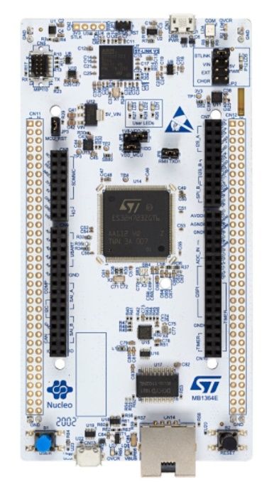

    • Nucleo-H723

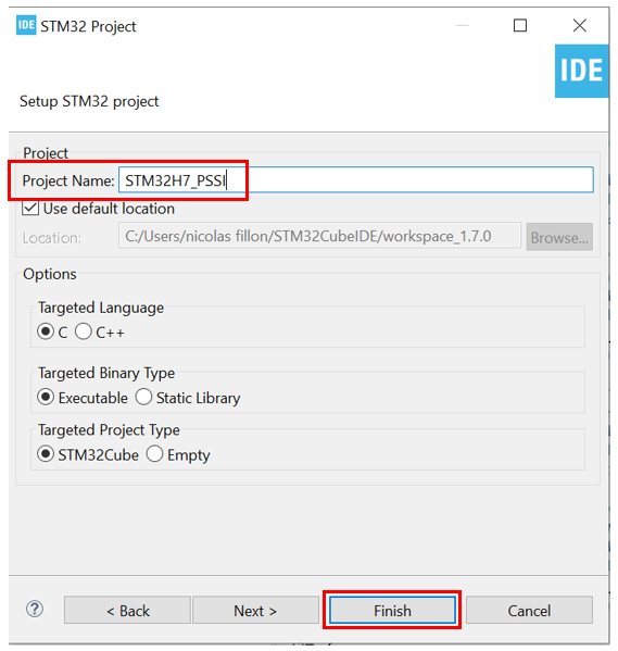

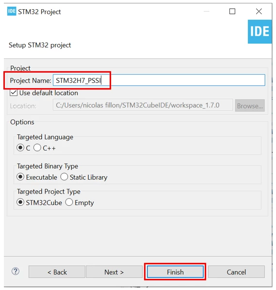

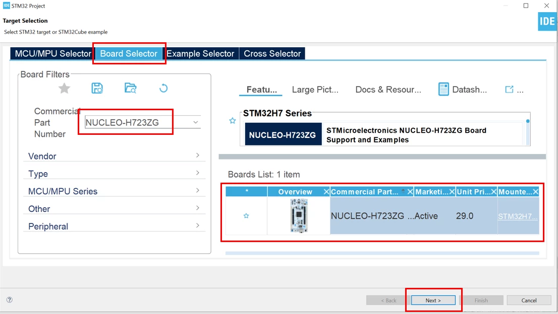

  2. Create a new project using the NUCLEO-H723 board
  1. Give a name to the project

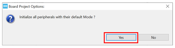

  1. Initialize all peripherals with their default settings

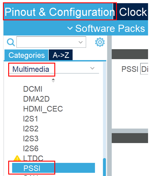

  1. Configure the PSSI
You will find the PSSI interface in the Multimedia category in the Pinout and Configuration Tab.

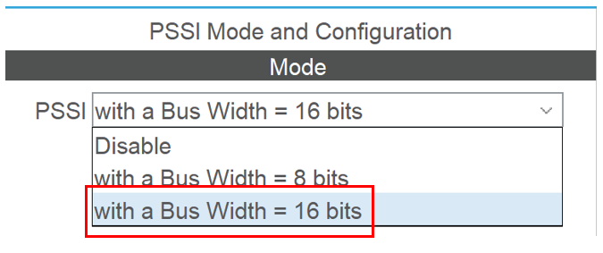

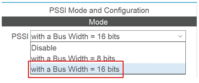

  1. Enable PSSI
Enable the interface. We will select a 16-bit interface from the PSSI Mode Configuration menu.

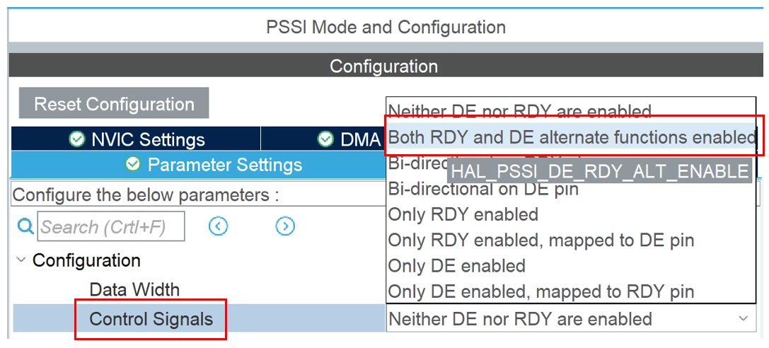

  1. Enable the hardware control signals
We will use both RDY (ready) and Data Enable (DE) signal for the communication.

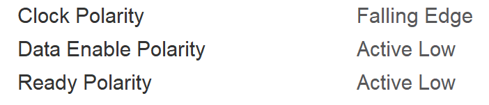

We will keep the rest of the configuration by default, but you should know that you can configure the clock polarity and the two flow control signals polarity:

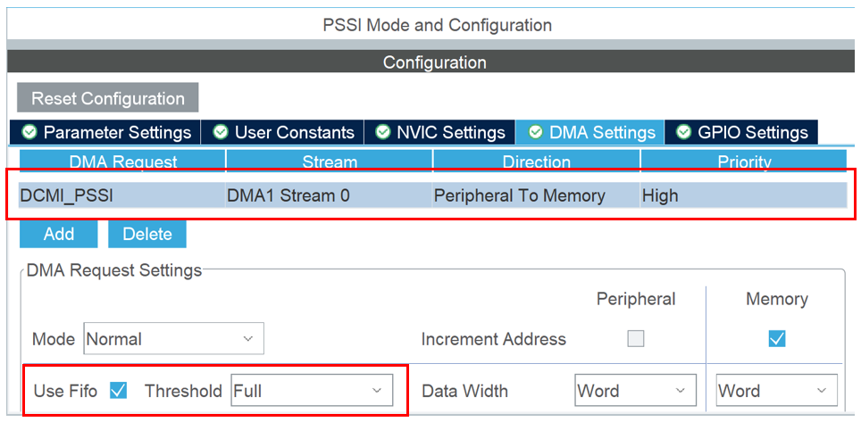

  1. Add DMA
We will DMA with FIFO to achieve the highest performance of data transfer between the 2 devices on the bus.

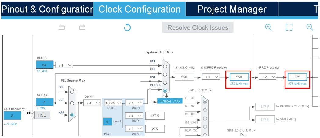

  1. Run the STM32 at max speed
Check that you are running at the max clock rate for the highest performance. The clock configuration should be as follows:
SYSCLK (CPU Clock) at 550 MHz
HCLK (AXI and AHBs Clock) at 275 MHz
