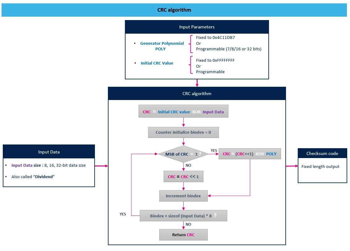

CRC algorithm embedded within the STM32 peripherals computes shift and XOR operations of a subsequent input data in functions of a Generator polynomial (POLY) and a programmable Initial CRC value.
Algorithm Input parameters:
  •  Input data also called “Dividend”. This is the data being transmitted or content of Flash for example.
  •  Generator polynomial or “Divisor”:
Algebraic polynomial represented as a bit pattern: the power of each term gives the position on the bit and the coefficient gives the value of the bit.
The order of the generator polynomial must not exceed the CRC length.
For a 32-bits CRC calculation, polynomial highest exponent must be 32.
By default, the standard generator polynomial used by the STM32 CRC peripheral is the Ethernet CRC-32 polynomial 0x04C11DB7. The mathematical representation according to this polynomial is x32 + x26 + x23 + x22 + x16 + x12 + x11 + x10 + x8 + x7 + x5 + x4 + x2 + x + 1. This presentation is obtained from the binary format of coefficients, where the 32-bit term is always present while the other terms are present only if the coefficient is equal to 1.
  •  Initial CRC value
Initial CRC value gives more security to CRC. It is fixed to 0xFFFFFFFF or programmable by user.
At start up, algorithm sets CRC to the initial CRC value XOR with the dividend.
Once CRC MSB is equal to one, algorithm shifts CRC one bit to the left and XORs it with the generator polynomial.
Otherwise, it only shifts CRC one bit to the left.

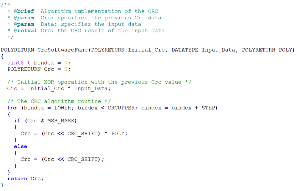

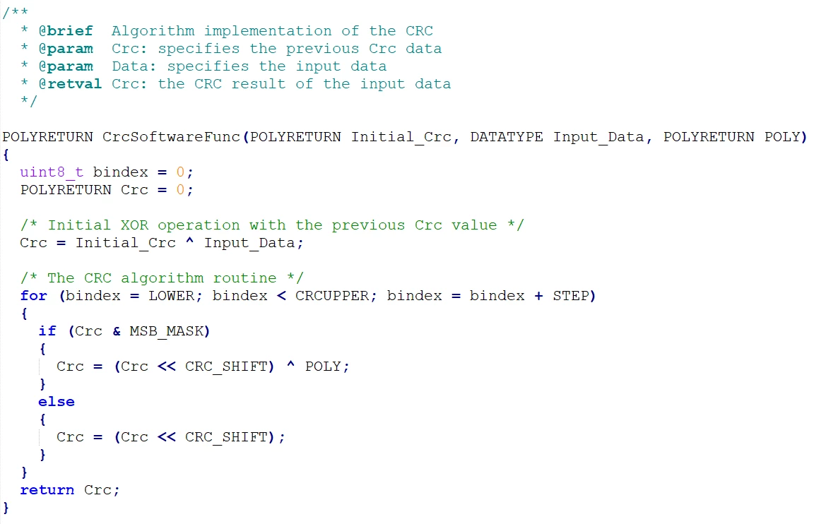

The equivalent embedded software implementation for the computation example of CRC is given in the function CrcSoftwareFunc below

To determine if your CRC is correct, you can calculate it with 3 different methods and compare the results.
There are different ways to compute CRC:
  • With your own algorithm implementation like CrcSoftwareFunc function (FW embedded in user application code)
  • With STM32Cube HAL library (STM32 CRC peripheral at user application level)
  • With an online calculator to check flash data integrity during the link step[YL1]

here is an example to show how the HAL_CRC_Calculate is working (STM32F407,STM32F107,...) and how to do the same calculation by yourself:
uint32_t Crc32(uint32_t Crc, uint32_t Data)
 uint8_t i;
 Crc = Crc ^ Data;
 for(i=0; i<32; i++)
 if (Crc & 0x80000000)
 Crc = (Crc << 1) ^ 0x04C11DB7; // Polynomial used in STM32
 else
 Crc = (Crc << 1);
 return(Crc);
