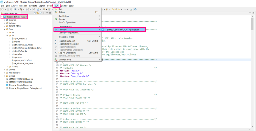

Connect the board to the computer and enter in debug mode by first clicking in the project name, then menu Run/Debug As/STM32:
In Edit Configuration window, click Debug:

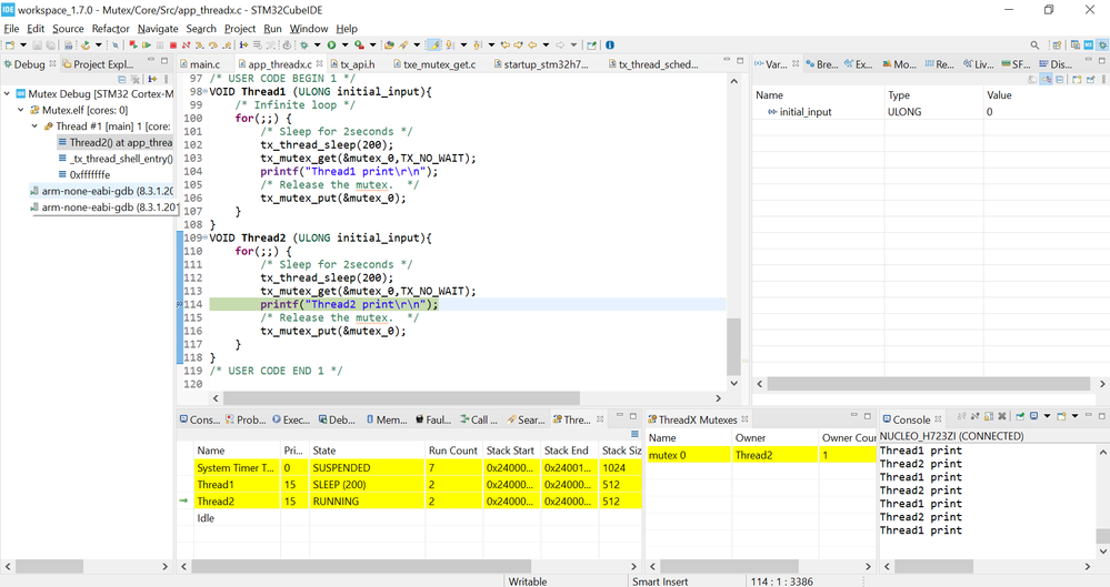

Once in the Debug perspective, click in the resume button to enjoy your ThreadX application with mutex working. You can also use the Window/Show View/ThreadX/ThreadX Thread List and do it again for the ThreadX Mutex to enhance the overall debugging options (the thread list will be automatically loaded once the application runs for a bit and is paused):

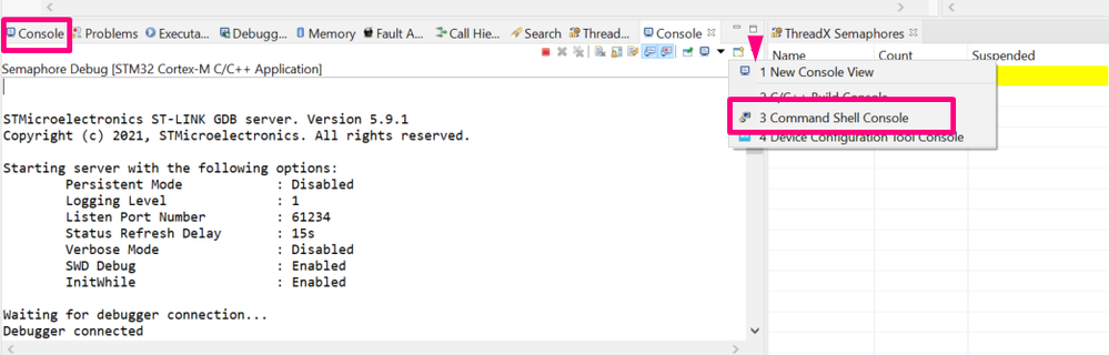

Now, the last step is to enable the console inside the STM32CubeIDE to see the print messages. Locate the Console tab and click Command Shell Console:

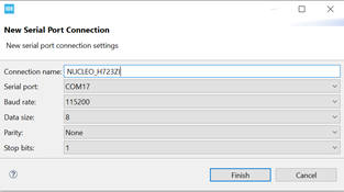

In the pop-up window, change the Connection Type to Serial Port and click on New… to add the VCOM related to your STLINK:
You can give the port a name, so it is easier for later usage as well, in this case, it will be labelled as NUCLEO_H723ZI:
By clicking finish, the message on the console will indicate it is now connected. By resuming the application (pressing F8), the printf messages will be displayed. Adding a breakpoint allows the Mutex and ThreadX information to be updated:
