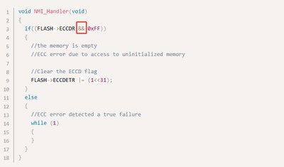

Below is an example of an NMI handler for this scenario:
void NMI_Handler(void)
 if((FLASH->ECCDR & 0xFF))
 //the memory is empty
 //ECC error due to access to uninitialized memory
 //Clear the ECCD flag
 FLASH->ECCDETR |= (1<<31);
 else
 //ECC error detected a true failure
 while (1)

August 12, 2025
这里是不是有问题?
Sarra.SAuthor
August 14, 2025
Hi @aa3, thanks for noting this!
Indeed it should be:
This will be corrected!
