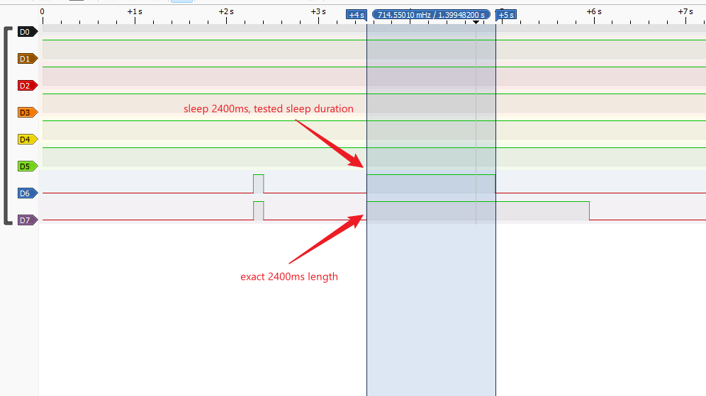

Why STM32WL Alarm always wakeup advance 1 second
SimonLaw
I use STM32WL RTC Alarm as low power mode timer for achieve ms level accrancy and any duration sleep. System will convert sleep time to Alarm time before enter low power mode. I have tested different  sleep time, verified convertion result is correct but system will always wakeup by Alarm advance 1 second than Alarm time. below is my RTC init and Alarm Setting Code:

Below is gpio reflect sleep time monitored by logic analyzer:
2 REPLIES 2
VictorD
Hello Simon,
Could you please provide some more information about the RTC configuration, including:
  • RTC input clock (you can retrieve this info on CubeMX or in the function HAL_RTC_MspInit() in the stm32wlxx_hal_msp.c file)
  • RTC_PREDIV_A value (the default value of RTC_PREDIV_A corresponds to 127. If the current clock input is LSE, which is the recommended input clock, it means ck_apre = 32768/128 = 256 Hz. With your current setting of RTC_BINARY_MIX_BCDU_2, the "1 second increment" is done every 4 seconds).
Regarding your configuration for sAlarm.AlarmSubSecondMask, since you are using the Binary_Mix mode, you should use RTC_ALARMSUBSECONDBINMASK_SS31_10 from the group RTCEx_Alarm_Sub_Seconds_binary_Masks_Definitions.
Also, could you please provide the code for the function subsecond_add()?
Best regards,
Victor
Hi, Victor,
I really appreciated the information you gave me. the more relative code may address the question:

  // when RTC work in mix mode, readout RTC value will less 1 second than correct value,
  // see RM0461 page 906: "SS can be larger than PREDIV_S only after a shift operation.
  // In that case, the correct time/date is one second less than as indicated by RTC_TR/RTC_DR."
  sTime.Seconds = 0x2;

void lptimer_set_timeout(uint32_t timeout)
  RTC_TimeTypeDef rtcTime = {0};
  RTC_DateTypeDef rtcDate = {0};
  HAL_RTC_GetTime(&hrtc, &rtcTime, RTC_FORMAT_BIN);
  HAL_RTC_GetDate(&hrtc, &rtcDate, RTC_FORMAT_BIN);
  LOG_I("RTC: %u %u:%u:%u %u", rtcDate.Date, rtcTime.Hours, rtcTime.Minutes, rtcTime.Seconds, rtcTime.SubSeconds);
  // when RTC work in mix mode, should need set RTC alarm add extra 1 second (equals RTC_PREDIV_S + 1
  // tick), see RM0461 page 906: "SS can be larger than PREDIV_S only after a shift operation.
  subsecond_add(&rtcTime, &rtcDate, timeout + RTC_PREDIV_S + 1);
