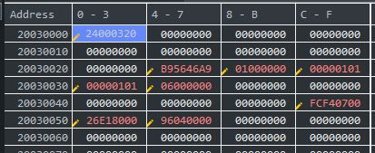

I need to be able to install/upgrade the CoPro from CPU1.
I get the FW for CPU1 and CPU2 by its system-bootloader via SPI from another STM32-MCU. Sadly FUS-commands in the System-bootloader are only supported by USB and UART.
Studying AN5185, this task sounds easy a.f., however i already fail by activating CPU2:
here is my current Workflow on the P-NUCLEO-WB55-Board with FUS v1.1.0 and deleted Stack:

Ensure IPCCDBA (option bytes) points to a valid shared table information structure in SRAM2a (fill correct pointers to device information table and system table)
 // struct with 6 ptr see: AN5185 Figure6 Shared table architecture
	IPCCDBA_T* pIpccdba;
	do {
		uint32_t ipccdbaOffset = LL_FLASH_GetIPCCBufferAddr();
		pIpccdba = (IPCCDBA_T*)((ipccdbaOffset<<2) + SRAM2A_BASE);
	} while(pIpccdba->pDeviceInfoTable->TableState != 0xA94656B9);
ipccdbaOffset = 0 => shared table reference start @ 0x20030000 => OK
i get valid data for the referenced Device-Info-Table @ 0x20030024, but no reference for the System-Table @ 0X2003000C (offset 3)
see:
If I am correct, the system table is set by the CoPro FW (Stack or FUS )?
I get the references when using other BLE-examples, however the longer i go through the examples and Datasheets/Application Notes, the more headache I get.
