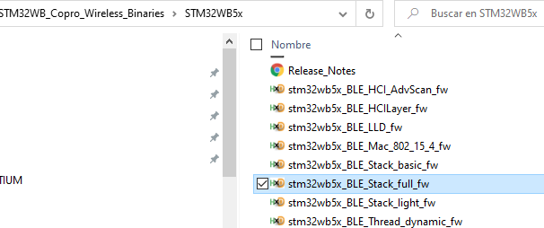

This application requires having the stm32wb5x_BLE_Stack_full_fw.bin binary flashed on the Wireless Coprocessor.
If it is not the case, you need to use STM32CubeProgrammer to load the appropriate binary.
All available binaries are located under /Projects/STM32_Copro_Wireless_Binaries directory.
Refer to UM2237 to learn how to use/install STM32CubeProgrammer.
Refer to /Projects/STM32_Copro_Wireless_Binaries/ReleaseNote.html for the detailed procedure to change the Wireless Coprocessor binary.
I found the binaries already

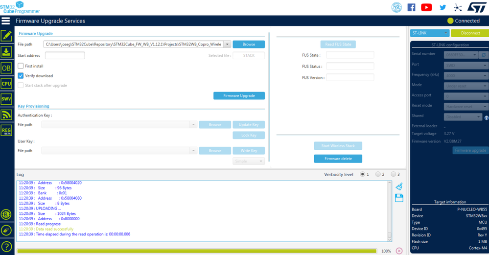

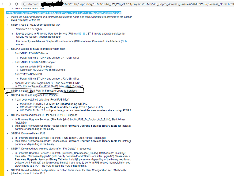

But as i try to follow the release note instructions i get stuck in STEP30693W00000DmNxaQAF.png
There is no "Start FUS" button anywhere, am i doing the raindance wrong?
Also if i try to "firmware upgrade" anyway is asking me for the start flash addr, thats not in any STEP

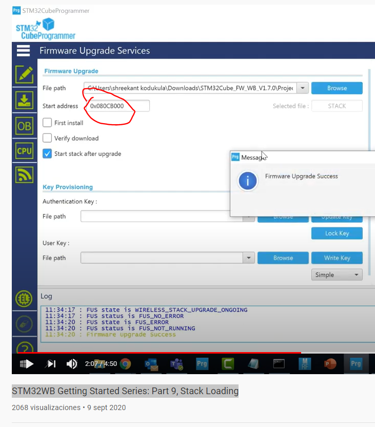

okay i found this video
STM32WB Getting Started Series: Part 9, Stack Loading
https://www.youtube.com/watch?v=wheGvdXsi4o

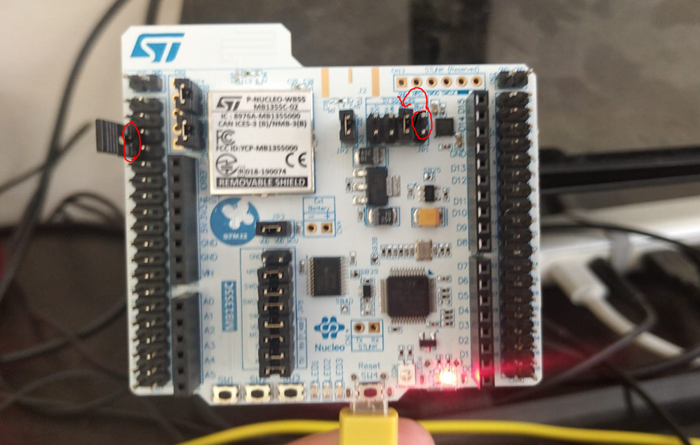

  • I needed to tie together cn7.7(boot0) to cn7.5 (3v3) in order to enter the usb bootloader mode when reset.
  • Also change the 5v powersource jumper to "USB MCU", so it can be powered trough the user usb port.
  • Then connect the USB cable to the user USB port not the st-link port.0693W00000DmOIMQA3.png

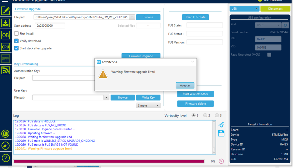

Im going to try and use the addr 0x080CB000 seen in the video
meeeeeeeeeec, warning, but it worked? 0693W00000DmOMoQAN.pnglogs:
12:06:19 : FUS state is FUS_IDLE
12:06:19 : FUS status is FUS_NO_ERROR
12:06:22 : Old Firmware delete ...
12:06:22 : Deleting firmware ...
12:06:22 : Firmware delete finished
12:06:22 : FUS state is FUS_SERVICE_ONGOING
12:06:22 : FUS status is FUS_IMAGE_NOT_FOUND
12:06:25 : FUS state is FUS_IDLE
12:06:25 : FUS status is FUS_NO_ERROR
12:06:27 : Download Stack/FUS image at address 0x80cb000 ...
12:06:27 : Memory Programming ...
12:06:27 : Opening and parsing file: stm32wb5x_BLE_Stack_full_fw.bin
12:06:27 :   File          : stm32wb5x_BLE_Stack_full_fw.bin

12:06:29 : Download in Progress:
12:06:31 : File download complete
12:06:31 : Time elapsed during download operation: 00:00:03.661
12:06:31 : Verifying ...
12:06:31 : Read progress:
12:06:32 : Download verified successfully
12:06:32 : FUS state is FUS_IDLE
12:06:32 : FUS status is FUS_NO_ERROR
12:06:34 : Firmware Upgrade process started ...
12:06:34 : Updating firmware ...
12:06:34 : Waiting for firmware upgrade end
12:06:35 : FUS state is WIRELESS_STACK_UPGRADE_ONGOING
12:06:35 : FUS status is FUS_IMAGE_NOT_FOUND
12:06:37 : Warning: Firmware upgrade Error!
