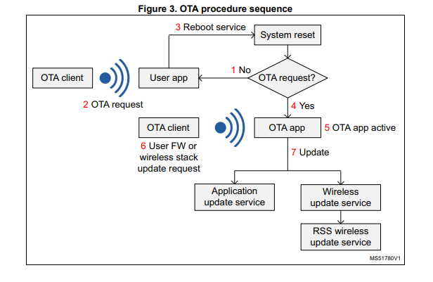

I am following this video link showing step by step to create OTA app.
https://www.youtube.com/watch?v=mRzZOa3jmuM.
I am successfully to create the custom application, download the OTA loader app at 0x08000000, and the custom's app at 0x08007000. The problem I am facing is whenever I sent some data to OTA Reboot characteristic, the custom app is just reset, then go back to the custom app. It didn't enter the OTA loader app. Am I missing something like the erase current app function? I also notice in my custom app, once the ST BLE tool box or ST BLE Sensor app connects to my device, it didn't show the OTA reboot option like when I tried the BLE_p2pServer_ota.

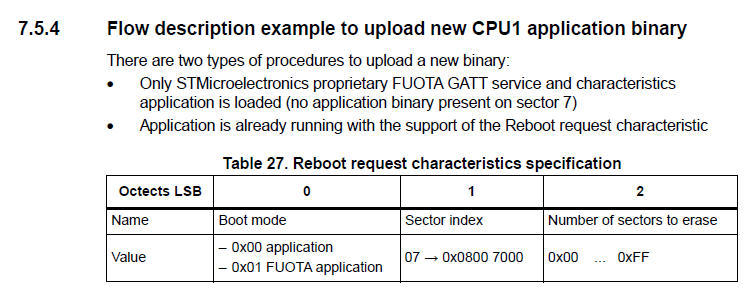

So I found this info,
When my device is up, it has the option "OTA Reboot Request" when I use ST Ble Toolbox,
I write Hex "000702" but nothing is happening
My code has
  case CUSTOM_STM_BOOT_REQUEST_EVT:
   *(uint32_t*)(SRAM1_BASE) = *(uint32_t*)pNotification->DataTransfered.pPayload;
   NVIC_SystemReset();
   break;
Do I understand the logic is OTA loader will use the information from SRAM1_BASE (which is define at 0x20000000UL, to erase my 2 sector starting at 0x08007000?
#define SRAM_BASE       (0x20000000UL)/*!< SRAM(up to 256 KB) base address */
#define SRAM1_BASE       SRAM_BASE         /*!< SRAM1(up to 192 KB) base address */
If I used the programmer, and manually erased 2 sectors starting from 0x08007000, after the power cycle, my device always comes up with STM_OTA which is the OTA loader application was loaded at 0x08000000.
Please suggest where should I need to double check or my errors.

Here is the general idea of procedure for OTA application:
  • {Ensure your BLE stack is update and running}
  • Flash OTA application at @0x08000000
  • Add OTA reboot characteristic to one of your BLE service
  • Managed the OTA reboot characteristic
In custom_app.c:
    case CUSTOM_STM_OTA_REBOOT_REQUEST_WRITE_EVT:
     /* USER CODE BEGIN CUSTOM_STM_OTA_REBOOT_REQUEST_WRITE_EVT */
   	APP_DBG_MSG("\r\n\r** OTA Reboot event!\n");
   	/* Write reboot reason at 0x20000000 (SRAM1):
   	 * Boot Mode: 0x00-> User Application (0x08007000), 0x01-> OTA application (0x08000000)
   	 * Sector index: 0x07 (7 sectors is the first to be program)
   	 * Number of sector to be erase (4K granulation): Filesize/4K + 1
   	 * Total: 3bytes (octets).
   	*(uint32_t *)SRAM1_BASE = *(uint32_t*)pNotification->DataTransfered.pPayload;
   	NVIC_SystemReset();
   	while(1);
     /* USER CODE END CUSTOM_STM_OTA_REBOOT_REQUEST_WRITE_EVT */
     break;

  • Ensure your MagicKeyword is correctly written (using STM32CubeProgrammer for exemple)
You may see the OTA procedure describe in this figure
AN5247 may be usefull for you.
