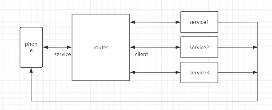

We are developing a Bluetooth application using the STM32WB55RG. According to the documentation, I found that using the Router and service approach can achieve a one-to-many connection. I want to know if, once a peripheral establishes a connection with the router, it can still connect to other phones. Can the router simultaneously connect to two phones, as shown in the diagram below? Additionally, I found an open-source project on GitHub that has a server-multiple client connection feature, but I am not sure how it is implemented. Could you provide any documentation on server-multiple client connections?

2024-11-19 8:55 AM
Hello @CHEN25 and welcome to the ST Community.
The WB device can support 2 connections as peripheral device (meaning connection to 2 central/master devices) and in // can manage additional connections with 6 peripherals (being a central/master device in this case). So, you can connect your router to two smartphones and connect a server to a Smartphone and a Router.

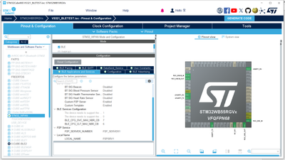

2024-11-22 1:29 AM
Thanks!I tried that, but the fact is that the second client can establish a new connection with the server only when the first client disconnects, and there is no effect of simultaneous connections. I have also confirmed that I am using STM32CubeWB V1.20.0. And here is part of the configuration for the test demo.

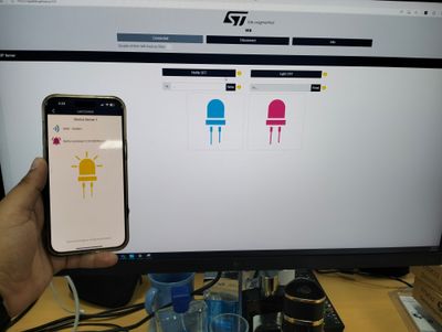

2024-11-22 7:17 AM - edited 2024-11-22 7:26 AM
Hello @CHEN25
I've been able to make it work on both Web Bluetooth App and my phone and also using two Smartphone (an Iphone and another android phone)
. You just have to:
Adv_Request(APP_BLE_FAST_ADV);to restart the advertising after the connection of the first central device. Now, your project will give you the opportunity to connect to the first device and after that you can connect to a second one will the first one is still able to advertise.
