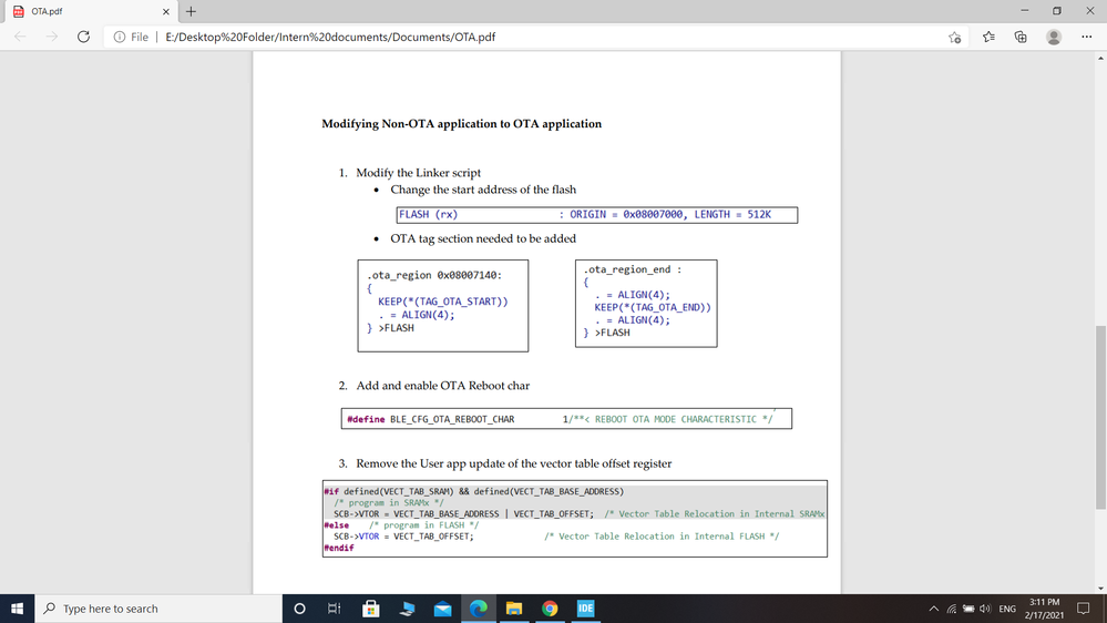

Refer these steps to modify non OTA file to OTA file

Thanks, But That exatly what I did but it still doesn't work.
